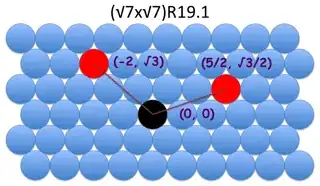

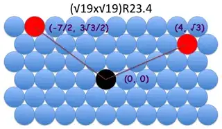

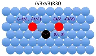

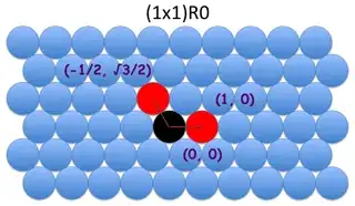

Below I show drawings of a hexagonal lattice with $a=1$ and the Wood's notation for four other commensurate hexagonal lattices.
Below I show the Wood's notation and the two new vectors themselves.
Question: I've found a trivial case and three more cases of commensurate hexagonal lattices where the second lattice is enlarged by a single scalar magnification and rotated so that its lattice points match those of the unit hexagonal lattice. I've done this by trial and error. Is there a systematic way that I can find all cases (if finite) or up to some limit in size if infinite?

$$\left(1 \times 1\right) \text{R} 0 \ \ \ \ \left[1, 0\right], \left[-\frac{1}{2}, \frac{\sqrt{3}}{2}\right]$$
$$\left(\sqrt{3} \times \sqrt{3}\right) \text{R} 30 \ \ \ \ \left[\frac{3}{2}, \frac{\sqrt{3}}{2}\right], \left[-\frac{3}{2}, \frac{\sqrt{3}}{2}\right]$$
$$\left(\sqrt{7} \times \sqrt{7}\right) \text{R} 19.1 \ \ \ \ \left[\frac{5}{2}, \frac{\sqrt{3}}{2}\right], \left[-2, \sqrt{3}\right]$$
$$\left(\sqrt{19} \times \sqrt{19}\right) \text{R} 23.4 \ \ \ \ \left[4, \sqrt{3}\right], \left[-\frac{7}{2}, \frac{3\sqrt{3}}{2}\right]$$

  • Wouldn't any individual cell in the 1/12-plane pizza slice (since anything past 30deg is going to have a similar reflective property) give a corresponding commensurate lattice? Like, it looks like you should also have $(2x2)R0$, $(\sqrt{13},\sqrt{13})R13.9$, using $(2,0)$ and $(7/2,\sqrt{3})$ respectively? – Dan Uznanski Aug 18 '19 at 16:48
  • @DanUznanski the first one I've ruled out in the last sentence, for the second one the lengths of those vectors are 2 and $\sqrt{61/4}$, neither of which are $\sqrt{13}$. – uhoh Aug 18 '19 at 22:38
    Yeah I meant $\sqrt{3}/2$ on the y coordinate of the last one, whups – Dan Uznanski Aug 18 '19 at 22:40
    Of tangential note, every scaling factor will be the square root of one of the numbers in http://oeis.org/A003136 – Dan Uznanski Aug 18 '19 at 22:51
Every non-origin cell in the lattice can be used to make a commensurate lattice.
We can generate all of them up to a given lattice-wise distance $d$ in this way:
Take two integers $0 < u \le v \le d-u$. Our target cell's location is $u$ cells up-right and then $v$ cells right, giving a coordinate of $\left(v + \frac12u, \frac{\sqrt{3}}{2}u\right)$, a scale of $\ell = \sqrt{u^2+v^2+uv}$ (the law of cosines to the rescue: $u$ and $v$ give distances along two vectors $1/3$ of a circle apart), and an angle of $\theta = \arctan\left(\frac{\sqrt{3}u}{2v + u}\right)$.
Each lattice then can be mirrored to the other half of the fundamental sixth of the plane by using $\frac{1}{6}\text{ circle} - \theta$ as the angle
If you need lattices that aren't simply scalings of other ones, simply insist on $\gcd(u,v)=1$.
