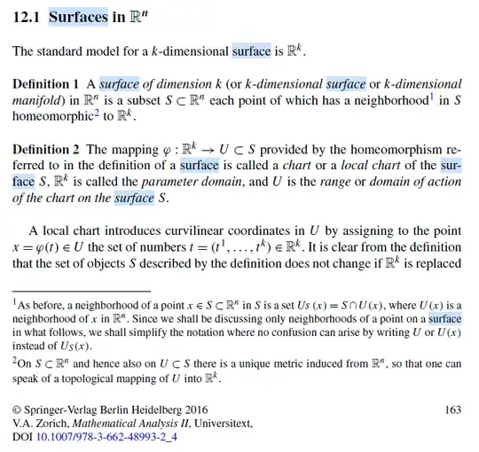

I have seen some authors who use "surface" as an equivalent of "manifolds".(Zorich, _Mathematical Analysis_) Personally I don't like it when someone refers to an $n$-dimensional manifold ($n\neq2$) as a surface; it is contradictory to intuition. But I wouldn't say it is wrong.
However, in your case, I do think it is wrong to confuse a "3-dimensional surface" with a "2-dimensional surface embedded in $\mathbb R^3$". I'd suggest changing it to "Bring formulas to life by exploring the multiple number of unusual surfaces they can create in three-dimensional space". (The audience probably wouldn't notice a thing.)

  • Even in the sense of this reference, these are ordinary $2$-dimensional surfaces (with $k=2$ and $n=3$). I'm leaning toward the opinion that specifying the dimension of the ambient space is totally unnecessary. In fact, many of the solutions to the equations in the exhibit have singularities and self-intersections, so talking about embeddings becomes more trouble than it's worth. – j0equ1nn Aug 07 '19 at 20:12

  • I like that you actually found a reference where "surface" is used in the way in question, as well as captured the sentiment of the math community, so I'm picking this answer. As discussed, I'll probably go with a different phrasing once I get to edit the text ... which, unfortunately, will take a while, but I do plan to do it! – j0equ1nn Aug 14 '19 at 14:33
