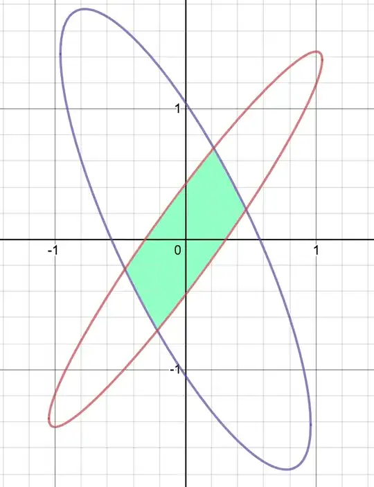

I need to find the area of intersection of two concentric ellipses. I imagine the concentricity should make this simpler than the general case, but the ellipses could be rotated.
Alternatively, if there is no simple solution to this. I could live with the area of parallelogram that is formed by the intersections points (when there are 4).
I don't have background in math or geometry, so any pointers is appreciated. Intersecting ellipses:

  • Do you have the equations of the ellipses? – N. Bar Aug 03 '19 at 21:24
  • Yes, They are of the form found here: https://math.stackexchange.com/questions/426150/what-is-the-general-equation-of-the-ellipse-that-is-not-in-the-origin-and-rotate/434482#434482 Except h, and k are zero. – Sia Rezaei Aug 03 '19 at 21:37

  • There's one special case asked here and we may have an oblique case as follows:
    $$\begin{array}{rcl} ax^2+bxy+cy^2<1 & \cap & cx^2-bxy+ay^2<1 \ A &=& \dfrac{8}{\sqrt{4ac-b^2}} \tan^{-1} \sqrt{\dfrac{a+c-\sqrt{(a-c)^2+b^2}}{a+c+\sqrt{(a-c)^2+b^2}}} \ a+c & > & 0 \end{array}$$
    – Ng Chung Tak Aug 04 '19 at 10:10
