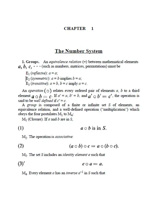

Is the following definition of '$=$' between numbers (natural, whole, rational, real, complex) correct?
$a=b$ iff $a$ and $b$ denote the same number.

This is the first page of my book "Classical Analysis"
It is said that '$=$' is an equivalence relation.
So what does the book mean by '$=$'?

  • What do you mean by "denote the same number"? This isn't very clear. – Mark Aug 03 '19 at 15:39
  • In this case, $=$ means equivalent and not equal. Usually this is written $a\sim b$ and not $a=b$. Therefore the confusion you had, perhaps. Your text has still the same question, so I cannot remove the duplicate. Actually, you already asked about this here. – Dietrich Burde Aug 03 '19 at 16:18
  • The page begins by defining the axioms of an equivalence relation, and to keep the notation succinct it works with algebraic expressions in which an arbitrary equivalence relation has a symbol, and the symbol chosen is $=$. Equality, the usual meaning of $=$, is just one equivalence relation; a different equivalence relation may be denoted $=$ if the context makes clear either (i) which one is intended or (ii) that arbitrary equivalence relations are being discussed, as here. – J.G. Aug 03 '19 at 16:20
    See the definition of group here. The wiki talks about "equality", not "equivalence". Does the equations $(2)$ and $(3)$ in my book refer to "equality" also? – Joe Aug 03 '19 at 16:31
    I think this is extremely awful, for at least three reasons. First, using "$=$" for an arbitrary equivalence relation, as in the first paragraph, is a very bad idea since that symbol has a different standard meaning, namely equality. (Do those equations refer to equality? Who can tell? The second big problem is he says something about an equivalence relation and an operation without introducing proper notation for them! To make the rest of the definition intelligible "an operation such that" should be ... – David C. Ullrich Aug 03 '19 at 16:57
    "an operation $\circ$ such that" - as it stands we have to guess that $\circ$ is "the operation". Similarly for "an equivalence relation" - if he'd specified the notation properly we wouldn't have to guess what $=$ means.) Third, there is no equivalence relation in the standard definitiion of "group"! The word "group" in this book means something different from what it means everywhere else - bad bad bad bad bad idea. If this is representative of the rest of the text you really need a different book. – David C. Ullrich Aug 03 '19 at 17:05

It's been commented that "usually" an equivalence relation is denoted by $\sim$ instead of $=$. It seems to me that in fact $=$ is never used for an equivalence relation (other than equality). Using $=$ for an arbitrary equivalence relation is a hugely bad idea.
(i) It causes confusion.
(ii) It means we have no way to denote actual equality! That's a problem, for example:
If $\sim$ is an equivalence relation a standard definition of the "equivalence class" containing $x$ is $$[x]_\sim=\{y:y\sim x\}.$$ If we're using "$=$" to denote an equivalence relation then how can we write that definition? It becomes $$[x]_==\{y:y= x\},$$which is impossibly bad notation: The symbol $=$ appears three times, twice referring to the equivalence relation under consideration and once to actual equality. Using the same symbol for two different things - totally wrong. I mean it looks like the author hasn't mastered basic undergraduate mathematical concepts.
(If as you say he's about to construct the real numbers then he will be talking about equivalence classes - I wonder how he gives the definition.)
