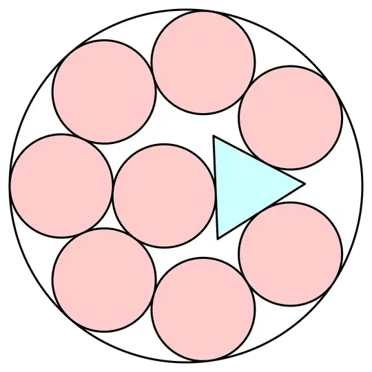

Seven years ago, one of my many contributions to the March 2010 edition of Erich Friedman's Math Magic was a packing of eight circles of unit diameter and one equilateral triangle of unit side length into as small a circle as I could manage.
To minimise the bounding circle's radius $r$, I had to determine the largest equilateral triangle externally tangent to the three circles adjacent to it, then numerically adjust $r$ until said triangle had side lengths $1$. This is not a trivial problem, and back then I did trial and error in GeoGebra. ($2r=3.4133707107\dots$)

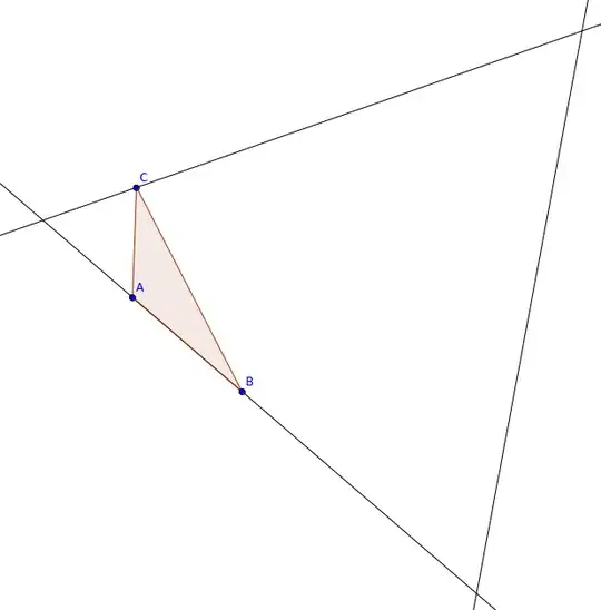

It is easy to see that the circles can be shrunk and the equilateral triangle enlarged about its centre while preserving tangencies, so the problem is equivalent to finding the largest equilateral triangle $\Delta^*$ where each edge is incident to one of $A,B,C$ where $A,B,C$ are the circle centres. The following construction doesn't count since one edge does not meet $\triangle ABC$:

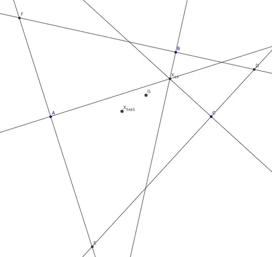

Now, having reinvigorated my interest in triangles, I believe I have found a construction for $\Delta^*$ for arbitrary $A,B,C$, and am asking here for a more traditional proof of its optimality. My construction proceeds as follows:
  1. Construct the first isogonic centre/Fermat point of the triangle, $X_{13}$ in the Encyclopedia of Triangle Centers (ETC). That is, construct outward equilateral triangles $A'BC, AB'C, ABC'$ on the sides of $\triangle ABC$, then $X_{13}$ is the concurrence of $AA',BB',CC'$.
  2. $\Delta^*$ is (conjecturally) the antipedal triangle of $X_{13}$.$^\dagger$ That is, $\Delta^*$ is the triangle formed by perpendiculars at $A,B,C$ of $AX_{13},BX_{13},CX_{13}$ respectively; it is guaranteed to be equilateral because the lines meeting at $X_{13}$ are evenly spaced around it.
The centroid of the triangle thus constructed is $X_{5463}$ in the ETC, the reflection of $X_{13}$ in the centroid of $\triangle ABC$, and its area is $\frac{a^2+b^2+c^2}{2\sqrt3}+2\operatorname{area}(\triangle ABC)$ where $a,b,c$ are the side lengths. (Alternatively, the area is $2\left(1+\frac{\cot\omega}{\sqrt3}\right)\operatorname{area}(\triangle ABC)$ where $\omega$ is the Brocard angle.)

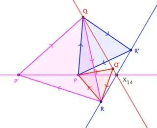

I'll use $\triangle PQR$ instead of $\triangle ABC$, to avoid some notational confusion.
First, a little prep work.

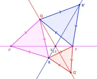

Given $\triangle PQR$, we erect on (directed) segment $\overline{PQ}$ an equilateral triangle $\triangle PQR'$ with a clockwise orientation. Similarly, we erect clockwise equilaterals $\triangle QRP'$ and $\triangle RPQ'$. As it happens, the lines $\overleftrightarrow{PP'}$, $\overleftrightarrow{QQ'}$, $\overleftrightarrow{RR'}$ meet at a common point, and do so symmetrically. When $\triangle PQR$ itself has a counter-clockwise orientation, the three equilaterals are external to it, and the three lines meet at the first isogonic center (Kimberling center $X_{13}$); when $\triangle PQR$ has a clockwise orientation, the equilaterals overlap its interior, and the common point is the second isogonic center ($X_{14}$).
In any case, we find that any triangle can be positioned such that each of its vertices lies on one of three concurrent, symmetrically-arranged lines. Taking the common point to be the origin, and one of the lines to be the $x$-axis, we can coordinatize $\triangle PQR$ thusly (abusing notation so that $\operatorname{cis}\theta := (\cos\theta, \sin\theta)$) as $$P := p \operatorname{cis} 0 \qquad Q := q \operatorname{cis}\tfrac23\pi\qquad R := r \operatorname{cis}(-\tfrac23\pi) \tag{1}$$ where we may assume $q$ and $r$ are non-negative (and not simultaneously zero). One can show that the $x$-intercept of $\overline{QR}$ is $-qr/(q+r)$; consequently, $\triangle PQR$'s orientation depends upon $p$'s relation to that value, and we can write $$\text{The origin is}\;\triangle PQR\text{'s}\; \left\{\begin{array}{c}\text{first} \\ \text{second} \\ \text{(either)} \end{array}\right\}\; \text{isogonic center if} \;\; p q + q r +r p \left\{\begin{array}{c} > \\ < \\ = \end{array}\right\} 0 \tag{2}$$

Importantly, the reader can verify that, at the key angle $\theta = \phi$ from $(\star\star)$, the lines through $P$, $Q$, $R$ with the direction vectors $u$, $v$, $w$ (the last two with their signs exchanged) meet at a point; specifically, they meet at $\triangle PQR$'s "other" isogonic center. This tells us that $T^\prime_\phi$ is actually the equilateral triangle obtained from OP's construction relative to that "other" center. Since, by $(7)$ and $(2)$, equilateral $T^\prime_\phi$ maximizes all triangles precisely when the "other" center is the first isogonic center, we have shown that
OP's construction relative to the first isogonic center is always maximal.
$\square$

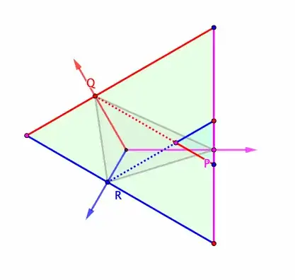

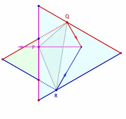

Here are a couple of animations, showing differently-oriented $\triangle PQR$ (counter-clockwise vs clockwise); the origin (unmarked black dot) is either the first or second isogonic center, respectively. Triangles $T_\theta$ are green, while $T^\prime_\theta$ are light blue.
These images highlight that, while the various equilateral triangles have side-lines passing through the vertices of $\triangle PQR$, not all have $\triangle PQR$ in their interiors; hence, they are not all "circumscribing" in the traditional sense.

  • Your second animation is misleading. Since the vertices $P,Q,R$ run in the opposite direction there, $X_{13}$ and the corresponding circumscribing equilateral triangle should be changed accordingly, but it hasn't. That is, the displayed location of the Fermat point is not correct. – Parcly Taxel Aug 04 '19 at 05:15
  • The condition for $T_0$ to have maximum area can also be written as $p\ge0$ or $p<0,\frac1p+\frac1q+\frac1r\le0$. If $p<0$ and the last inequality of reciprocals is an equality, then negating $p$ (so it is a positive number) we get $\frac1p=\frac1q+\frac1r$. This is precisely the condition for $P,Q,R$ to be collinear (the Fermat point flips as $P$ is moved across $QR$). Thus $T_0$ is in fact the maximum area circumscribing equilateral triangle for all triangles (save for the caveat at the end of my question body). You should probably correct your answer in light of this. – Parcly Taxel Aug 04 '19 at 05:53
  • @ParclyTaxel: The images are correct with respect to the coordinatization given in $(1)$. Nevertheless, my description is in error. I wrote that the "first isogonal center" is at the origin, but, for $p<0$ past the threshold of $\overline{QR}$, the origin becomes the second isogonal center. I'd intended to describe the point merely as where three symmetrically-arranged lines through the vertices concur, in order to justify $(1)$. Editing on-the-fly seems to have made me a bit lazy, and this had consequences when connecting $T$ and $T'$ to your specific construction. I'll update. Thanks! – Blue Aug 04 '19 at 06:49
