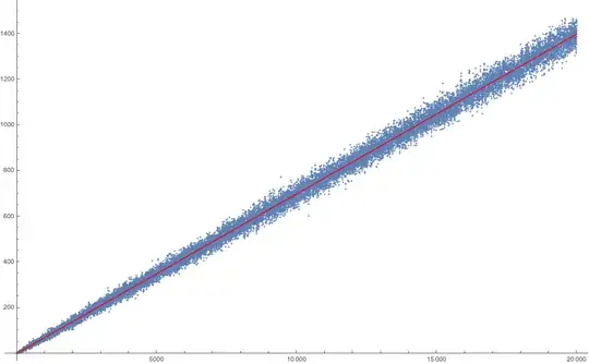

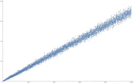

A good picture is worth a thousand words. It seems that the number of zeroes is growing in an almost linear fashion with a fair amount of "noise" around the meadian line. Here are the results for a number of zeroes in $5^n$ up to $n=10,000$
Not much will change if you extend the range to $n=20,000$:
Linear fit gives the following approximation:
$$n_{zero}=0.0699383 n-0.606536$$
...which means that the number of zeroes is roughly around 7%.
Mathematica provides the following regression analysis:
$$\begin{array}{l|llll} \text{} & \text{Estimate} & \text{Standard Error} & \text{t-Statistic} & \text{P-Value} \\ \hline 1 & -0.606536 & 0.354669 & -1.71015 & 0.0872544 \\ x & 0.0699383 & 0.0000307141 & 2277.07 & 5.874\cdot 10^{-24155} \\ \end{array}$$
If you try to fit the data with a parabola you get the following approximation:
$$n_{zero}=0.0931693 + 0.0697284 n+1.0494\cdot 10^{-8}n^2$$
In the given range, the quadratic term is almost neglectable which supports the conjecture that the relation between the exponent and the number of zeroes is approximately linear.

  • (+1) Would you mind sharing the code from Mathematica? – TheSimpliFire Jul 01 '19 at 08:10
    There will be about $n\log_{10}5=0.7n$ digits, so that would make it about ten percent of the digits. The first one and last three won't be, but that is a small effect. – Empy2 Jul 01 '19 at 08:14
  • @TheSimpliFire I have updated the answer with the code. – Oldboy Jul 01 '19 at 09:25
  • The difference between the coefficient on $n$ in your linear equation and $(\log_{10}5/10$ is less than two standard deviations. Looks like a very complicated way to say that we have the expected occurrence of zeroes based on a uniform distribution of digits. – Oscar Lanzi Jul 01 '19 at 09:28
    These calculations confirm our intuitions, but of course they prove nothing. – Gerry Myerson Jul 01 '19 at 10:38
    Not only this proves nothing, but it's barely related with the OP's goal: the question is not about the mean or approximate average number of zeroes, but about bounding the worst case. That is, is $z_n$ is the number of zeroes, we want to find some $\alpha$ such that $z_n/n \le \alpha $ for all $n$. In particular we want to know if $\alpha=0.5$ works . – leonbloy Jul 01 '19 at 12:17
  • @leonbloy The OP said: "But I'm hoping to prove some properties about $5^n$ in general which require the non-zero digits to be at least linear in n." I did not prove that non-zero digits are at least linear in $n$, but the data provided is a strong indication. So I don't agree that my answer is "barely related" with OP's goal. But you can always downvote my answer. – Oldboy Jul 02 '19 at 08:24
