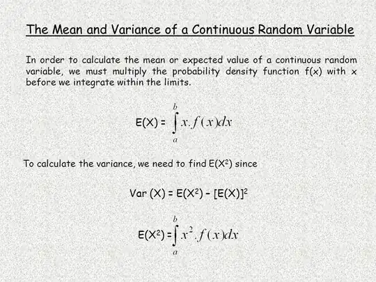

Letting $E[X]= E[X^2] - (E[X])^2$, can anyone explain why $E[X^2]$ is simply the integral over $x^2f(x)$ instead of $f(x)^2$ ?
For example in the below picture: enter image description here
Why isn't the last line $f(x)^2$ instead of $x^2f(x)$ since $X$ simply describes $f(x)$? It doesn't make sense as it takes the expectation outside the domain of $X$ if it has finite bounds.

This is a particular case of the "Law of the Unconscious Statistician". $$\mathsf E[g(X)]=\int_\Bbb R g(x)~f_X(x)~\mathrm d x$$
Let $Z=X^2$
$\begin{align}\mathsf E(X^2) &=\mathsf E(Z)\\&=\int_{\Bbb R^+} z~f_{Z}(z)~\mathrm d z\\&=\int_{\Bbb R^+} x^2~f_{X^2}(x^2)~\mathrm d (x^2)\\&=\int_{x^2\in\Bbb R^+} x^2~\mathrm d \mathsf P(X^2\leqslant x^2)\\&=\int_{x\in\Bbb R^+} x^2~\mathrm d\mathsf P(-x\leqslant X\leqslant x)\\&=\int_{x\in\Bbb R^+} x^2~\mathrm d\mathsf P(X\leqslant x)+\int_{x\in\Bbb R^-}~x^2~\mathrm d \mathsf P(X\leqslant x)\\&=\int_\Bbb R x^2~f_X(x)~\mathrm d x\end{align}$

Because this is how it is "defined". For an absolutely continuous random variable $X$ with probability density function $f$ and a measurable function $g$, we have $$\mathbb{E}[g(X)]= \int g(x) f(x) dx.$$ In your case, $g(x)= x^2$.
EDIT: If you want a rigorous explanation of the formula above, have a look into transformation formula for pdfs.
max
  • 322
  • I don't follow this because it is E[X^2] where X is a capital letter, i.e. representing f(x) – edd91 Jun 30 '19 at 06:30
  • No, $f(x)$ is the p.d.f. of $X$, it stays unchanged. The function you try to find expectation of is $g(X)$, which is in your case $g(x)=x^2$. – max Jun 30 '19 at 06:31
  • This is not the definition of $E(X^2)$, it's a consequence of the Law of the Unconscious Statistician. – littleO Jun 30 '19 at 07:05
    I agree. It's a consequence of transforming one pdf into another, which is the consequence of basic change of variables... Never heard of the "Law of the Unconscious Statistician" though. I believe for the question it was useful to understand the difference between the pdf $f(x)$ and the function $g(x)$. – max Jun 30 '19 at 07:24
