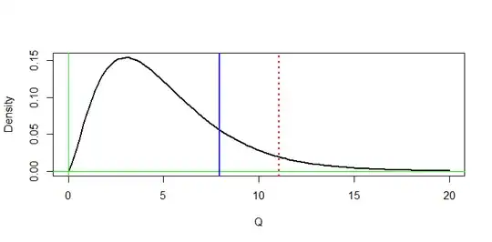

In the figure below the density function of $\mathsf{Chisq}(5)$ is shown along with the observed value $Q = 7.92$ (solid vertical line) and the critical value $c = 11.0705$ (dotted vertical line). The P-value is represented by the area to the right of the solid vertical line.

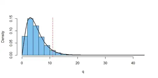

The simulation below shows that the true significance level using critical value $c = 11.0705.$ is very nearly 5%. The simulation is based on finding the value $Q$ for a million 150-roll experiments with a fair die.

The histogram of the one million simulated values of $Q$ is shown below along with the density curve of $\mathsf{Chisq}(5).$ The proportion of the simulated $Q$'s to the right of the critical value $c$ is very nearly 5%.

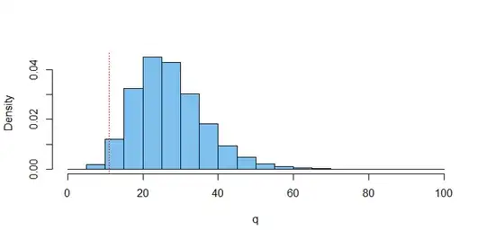

A simulation with such a biased die is shown below. We see that the power of the test against this alternative distribution is about 98.5%. So we the test is almost sure to reject the null hypothesis that such a die is fair.
