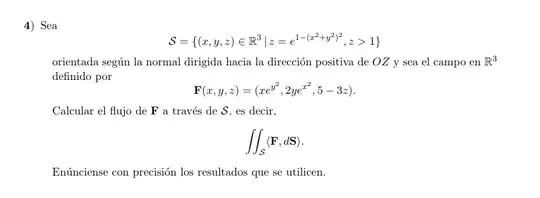

Here is the original question in Spanish.
exam question
    No disrespect but are you sure the question asks to find the flux itself and not the surface integral of the CURL of the vector field? The question seems to have been tailored so that the surface integral of the curl is easily calculated through applying stokes' theorem and it comes down to evaluating the integral of $\cos\left(\theta\right)\sin\left(\theta\right)e^{\sin^2\left(\theta\right)}$ along the unit circle ; which is exactly the type of question you'd expect in this exam. – Km356 Jun 12 '19 at 08:10
  • Yes, I am. I have added a picture of the question as it was asked in the exam, in Spanish. If I must be honest, part of me believes there must be something wrong with the question. Several PhD candidates have had a go at it, to no avail... and that's why I set a bounty! My main problem with using Stokes and carrying the thing to the border is that I know no viable integral to compute there. – Sam Skywalker Jun 12 '19 at 09:36
