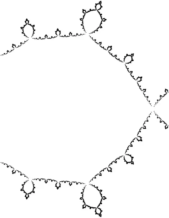

There is an exact relation to fractals and holomorphic dynamics. Using $f(z)=P\circ...\circ P(f(a^{-n}z))$, $P(z)=z^2-1$, we obtain that if $z_0$ (located in the strip $S_n:=\{z:\ a^n\leq|z_0|<a^{n+1}\}$) is a primitive zero of $f$, i.e. $f(a^{-k}z)\neq0$, $k\geq1$, then $f(a^{-n}z_0)$ is a non-trivial root of the polynomial $P_n=P^{\circ n}$. All such non-trivia roots have the form $$ q= s_0\sqrt{1+s_1\sqrt{1+...+s_{n-1}\sqrt{1+s_n\sqrt{2}}}}, $$ where $s_j\in\{-1,1\}$. Without loss of generality, consider the case $f'(0)=1$. Then, for sufficiently large $n_0$, we have $$ \frac{a}2+a^{-n-n_0}z_0\approx f(a^{-n-n_0}z_0)= s_0\sqrt{1+s_1\sqrt{1+...+s_{n-1}\sqrt{1+s_n\sqrt{2}}}}. $$ Hence $$ a^{-n-n_0}z_0\approx s_0\sqrt{1+s_1\sqrt{1+...+s_{n-1}\sqrt{1+s_n\sqrt{2}}}}-\frac{a}2(=q) $$ and all such $q$ lying in $a^{-n_0}\leq|q|<a^{-n_0+1}$ correspond to primitive roots of $f$ lying in $S_n$. I have computed them for $n=20$ (and $n_0=4$):
 Primitive zeros in the large ring
It looks like a Julia set. So, zeros of $f$ (even primitive zeros) are very complex. I hope I did not make large mistakes somewhere...

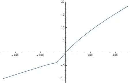

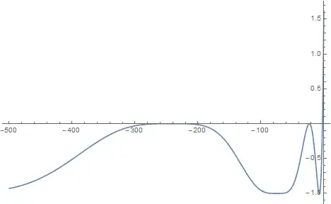

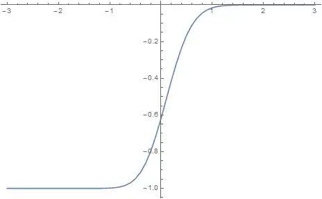

Next, numeric calculations. For $a = 1+\sqrt{5}$ case, the power series for $f_*$ has infinite radius of convergence and converges quickly, meaning we can calculate it numerically easily. For $x>0$, it scales roughly as $\exp(0.941x^r)$, where $r = \ln(2)/\ln(1+\sqrt{5})$ (thanks DinosaurEgg for that exponent) . For $x < 0$, it oscillates between 0 and 1 like this:
Each zero is $a^2$ times the previous and has double the order, as you found.
For $a = 1-\sqrt{5}$, the power series converges extremely slowly. Its behavior is very erf-like: enter image description here
Lastly, for your infinite product representation, $h(x)$ scales as something like $0.072x^r\ln(x)$ at large positive $x$. Overall it looks like this
so I don't think it will have a simple form.
EDIT: I calculated a power series representation to 80 terms and totally forgot to check for zeros in $\mathbb C\setminus \mathbb R $. Bad news: it has them. A lot of them. For every solution to $f(z) = \pm \sqrt{2}$ and $n \ge 1$, $a^{2n}z$ is a zero. And there are infinitely many solutions to that, which means the infinite product plan probably won't work.
EDIT2: OK, so it seems the power series for the $a = 1-\sqrt{5}$ case actually does converge, just incredibly slowly--the coefficients go something like $\exp(-0.036n^{1.6})$, which grows faster than any exponential function but takes a hell of a lot of time to get there. Not sure if that exponent is $1+r$ or $(1+\sqrt{5})/2$.

  • actually, the asymptotic behavior as $x\rightarrow\infty$ is of order $e^{\delta x^r}$, $r=\frac{\ln 2}{\ln a}$, as determined by performing dominant balance analysis on the equation. ($\delta$ is undetermined by the method I used, and also i couldn't produce subleading terms) – K. Grammatikos May 31 '19 at 00:14
    @DinosaurEgg Well that's certainly consistent with my result, as $\ln(2)/\ln(1+\sqrt{5}) \approx 0.590234$. – eyeballfrog May 31 '19 at 00:22
  • I think $\delta$ must depend on the value of $f'(0)$ but I have no idea how to determine it. Care to do a graph of the exponent varying the derivative ? – K. Grammatikos May 31 '19 at 00:47
    @DinosaurEgg It's a perfect power law: $\delta = 0.941f'(0)^r$. Of course that still doesn't explain the $0.941$. – eyeballfrog May 31 '19 at 03:18

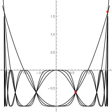

Also regarding the functions $F(k,y)$ they have a behavior shown in the following plot. Here are shown $F(0,y),\cdots, F(5,y)$. All curves intersect at
$$ \left(\frac{1}{2} \left(\sqrt{5}-1\right),\frac{1}{2} \left(1-\sqrt{5}\right)\right),\ \ \left(\frac{1}{2} \left(1+\sqrt{5}\right),\frac{1}{2} \left(1+\sqrt{5}\right)\right) $$
