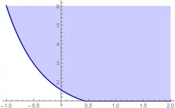

Plot for
$$ g(x,k)=\frac{1}{\min[k,\log_3(1+5^x)]} $$
with $k = 1$
