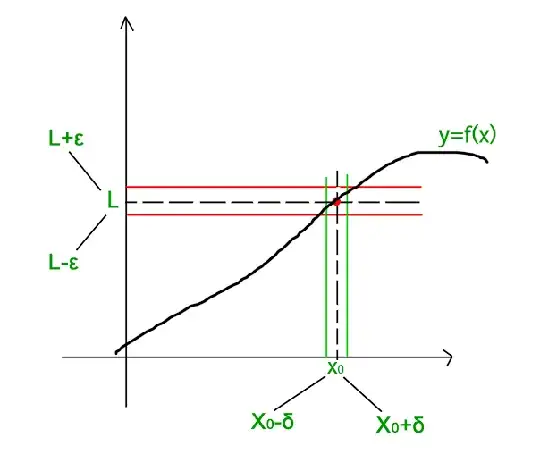

Uniform continuity simply means the turning of the graph is uniform. More intuitively, the sharpness of the turns are somewhat limited.
enter image description here If you properly understand the meaning of the definition of continuity then look at the intersection of the boxes. For continuity, at each point you get a delta which may change if you change your point of interest. That means, the size of the box changes as you move along the curve. But if your function is uniformly continuous then you can move the box along the curve without changing the size and still the off diagonal endpoints be on the curve. (image source: https://www.geeksforgeeks.org/mathematics-limits-continuity-differentiability/)
