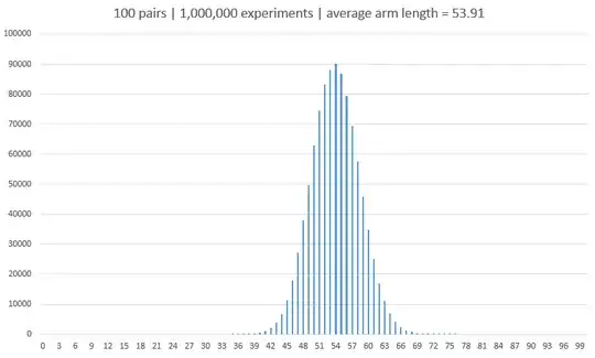

First, I made 1,000,000 experiments with 100 pairs of socks and recorded maximum arm length reached in each one. For example, maximum arm length of 54 was reached about 90,000 times. And it all looks like a normal distribution to me. The average value of maximum arm length was 53.91, confirmed several times in a row.

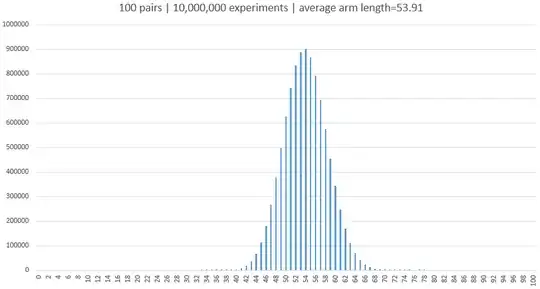

Nothing changed with 100 pairs of socks and 10,000,000 experiments. Average value remained the same. So it looks like you need about a million runs to draw up a meaningful conclusion.

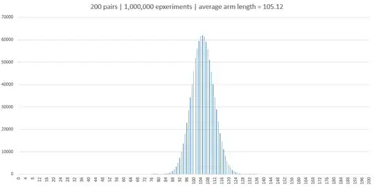

Here is what I got when I doubled the number of socks to 200 pairs. Maximum arm length on average was 105.12, still above 50%. I got the same value in several repeated experiments ($\pm0.01$).

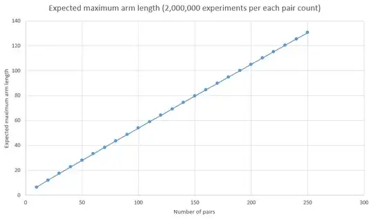

Finally, I decided to check expected maximum arm length for different number of sock pairs, from 10 to 250. Each number of pairs was tested 2,000,000 times before the average value was calculated. Here are the results:
$$ \begin{array}{c|rr} \textbf{Pairs} & \textbf{Arm Length} & \textbf{Increment} \\ \hline 10 & 6.49 & \\ 20 & 12.03 & 5.54 \\ 30 & 17.41 & 5.38 \\ 40 & 22.71 & 5.30 \\ 50 & 27.97 & 5.26 \\ 60 & 33.20 & 5.23 \\ 70 & 38.40 & 5.20 \\ 80 & 43.59 & 5.19 \\ 90 & 48.75 & 5.16 \\ 100 & 53.91 & 5.16 \\ 110 & 59.07 & 5.16 \\ 120 & 64.20 & 5.13 \\ 130 & 69.33 & 5.13 \\ 140 & 74.46 & 5.13 \\ 150 & 79.58 & 5.12 \\ 160 & 84.69 & 5.11 \\ 170 & 89.80 & 5.11 \\ 180 & 94.91 & 5.11 \\ 190 & 100.02 & 5.11 \\ 200 & 105.11 & 5.09 \\ 210 & 110.20 & 5.09 \\ 220 & 115.29 & 5.09 \\ 230 & 120.38 & 5.09 \\ 240 & 125.47 & 5.09 \\ 250 & 130.56 & 5.09 \end{array} $$
It looks like a straight line but it's actually an arc, slightly bended downwards (take a look at the increment column).
