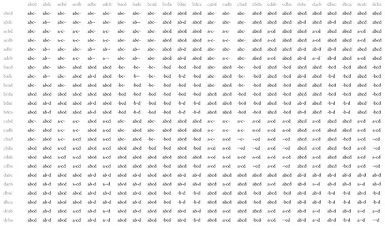

Not a full answer, but too long for a comment. Here's a compact representation of the graphs:
Each permutation is paired up with each other permutation. The entry in the table records whether there is an edge from the permutation on the left to the permutation on the top in the graph $G_{a,b}$, $G_{b,c}$, $G_{c,d}$, and $G_{d,a}$. For shorthand, these graphs are denoted by the presence or absence of a single letter, e.g. if there is an edge in $G_{a,b}$, I write $a$ in the entry. Same for $G_{b,c}$ and $b$, $G_{c,d}$ and $c$ etc.
I figure such a table may be helpful for visualization and determining an answer to this question.
