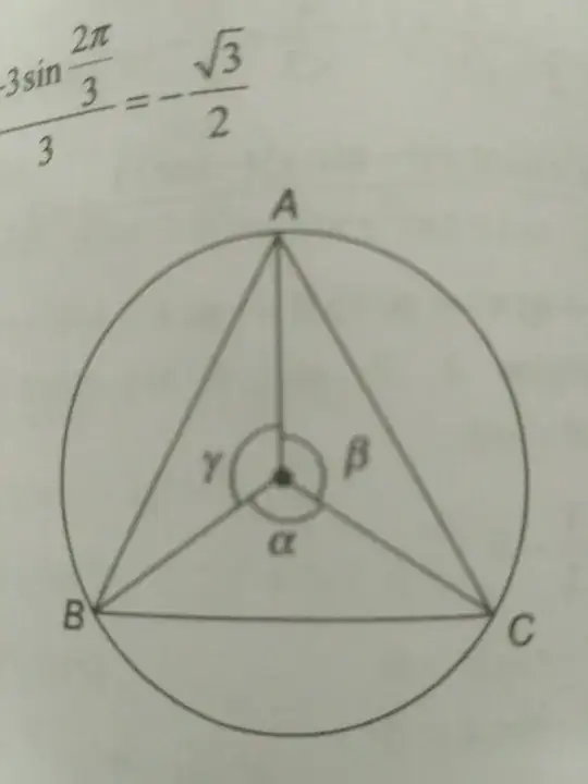

The side of a triangle inscribed in a given circle subtends angles $a, b,$ and $y$ at the center. The minimum value of the arithmetic mean mean of $ \cos (a+ \frac{\pi}{2}), \cos(b+\frac{\pi}{2})$ and $\cos(y+\frac{\pi}{2}) $ is . . . ?
One thing I noticed here is that either $a + b+y = 2 \pi $ a+B+y = pi

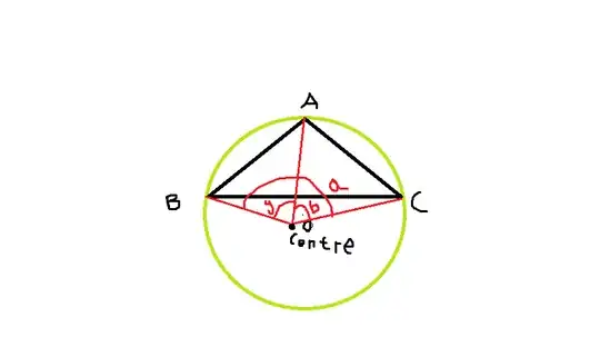

or $a+y = b$ enter image description here.
I used a diagram. I don't know if there is a more rigorous way to prove that. The problem can be solved if$ a + b + y = 2 \pi $ but what if it is the other case?
My book solve this problem using AM GM inequality but all these terms are negative so how can that be valid here , also they forgot the other case???

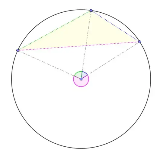

enter image description here In fact, we didn't consider the angle subtended by $\color{fuchsia}c$ correctly! And we are done!

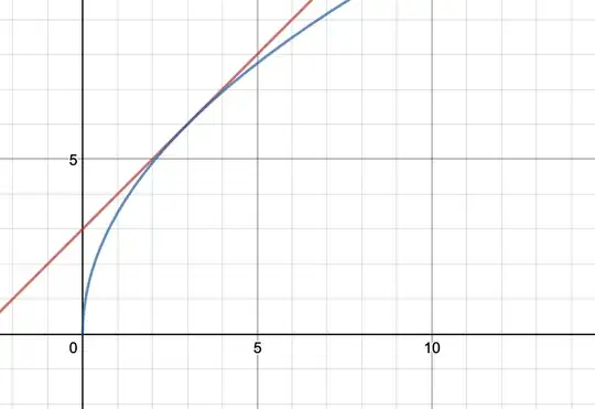

Consider for instance $f(x):=x+3$. With the same argument given by your book, $f(x)_{min}$ in $(0, \infty)$ is achieved when $x=3$. But this is wrong!
Of course $$x+3\ge 2\cdot \sqrt{3x}$$
and they are equal when $x=3$. But this doesn't imply that $x=3$ gives the minimum value for $f$...
