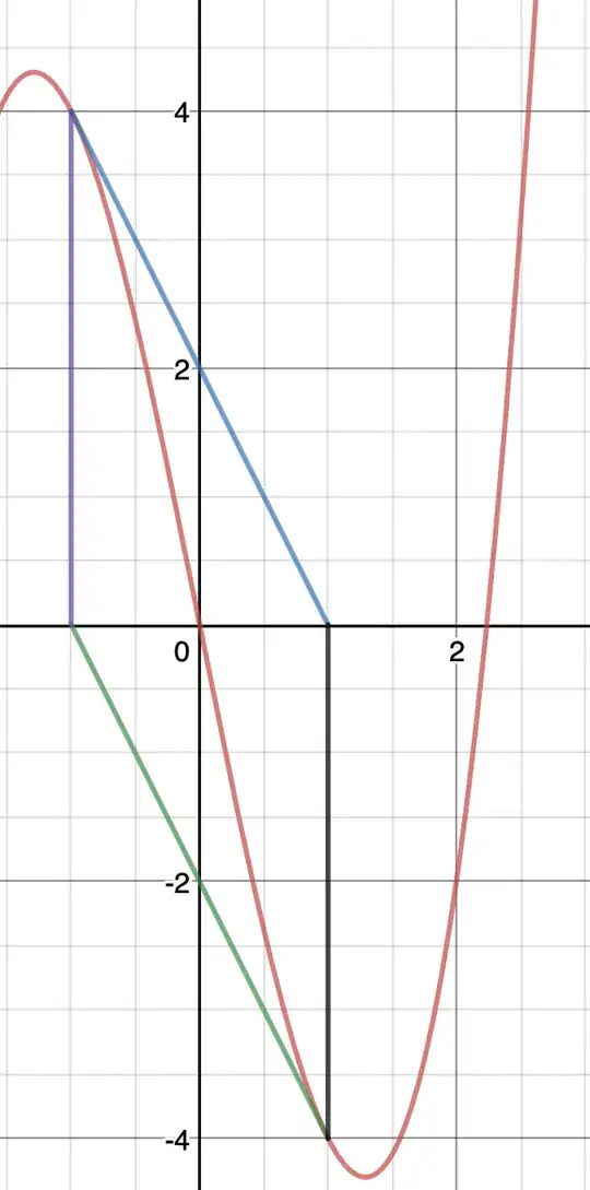

Geometrically, what has happened is you are trapped in the following cycle.
Starting from $(1,-4)$, by traveling along the tangent, we intercept the $x$-axis at $x=-1$. From $(-1,4)$, by trveling along the tangent, we intercept the $x$-axis at $x=1$.
