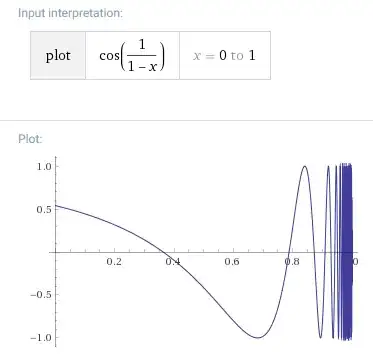

The first bullet is ruled out by the stipulation that $f$ be bounded, so moving on to the second bullet, we need to make sure $\displaystyle \lim_{x \to 1} f(x)$ does not exist. One way of doing this (the only way I believe) is to have $f$ oscillate infinitely rapidly with non-vanishing amplitude as $x \to 1$. It looks like this is what you were trying to exploit, and what José Carlos Santos did (+1) in his answer (see graph below): $\displaystyle f(x) = \cos \left(\frac{1}{1-x} \right)$.
Generalizing his epsilon-delta argument, you can see that this condition is not only necessary, but also sufficient.
$\qquad \qquad \qquad \qquad$ enter image description here
