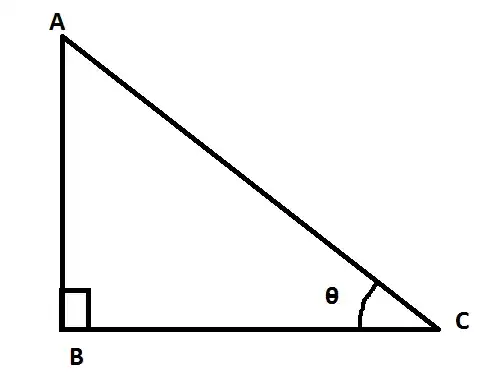

These identities can be shown by using the trigonometric addition formula, as the other answer shows. However, this may not help with the geometric insight. You can see this with either the triangle perspective, or the unit circle perspective. Here is how.
The angle in this triangle at ACB is $\theta$. The angle at BAC therefore, is $\frac\pi2-\theta$. The side BC is equal to $\cos\theta$, and is also equal to $\sin\left(\frac\pi2-\theta\right)$. Similarly, the side AB is equal to $\sin\theta$, and is also equal to $\cos\left(\frac\pi2-\theta\right)$. So we're done.
