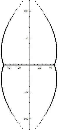

Faulhaber polynomial of order $p \in \Bbb{N}$ is defined as the unique polynomial of degree $p+1$ satisfying
$$ S_{p}(n) = \sum_{k=1}^{n} k^p $$
for $n = 1, 2, 3, \cdots$. For example,
\begin{align*} S_0(x) &= x, \\ S_1(x) &= \frac{x(x+1)}{2}, \\ S_2(x) &= \frac{x(x+1)(2x+1)}{6}, \\ S_3(x) &= \frac{x^2 (x+1)^2}{4}. \end{align*}
In order to grasp some intuition on the partial decomposition of $1/S_p (x)$, I tried plotting the complex zeros of $S_p (x)$. The following graphics shows the distribution of the zeros of $S_{800}(x)$.
(The precision of the calculated zeros $z_j$ of $S_{800}(z)$ above satisfy $|f(z_j)| \leq 10^{-300}$.)
It turns out that they exhibits a very neat, yet still a strange pattern as seen above.
So far I have never heard of the topic related to this pattern, and I want to know (out of curiosity) if there are some results concerning the pattern of zeros of $S_p(x)$.

    A classic example of this type of problem appears as the Szego curve. Unfortunately I cannot recall any general references for this type of problem. Though the Faulhaber's are not Taylor polynomials, so maybe not as related as I might wish. [As an aside, this was also my first thought when I saw that $\sum(1+\cdots+n^p)^{-1}$ problem :) ] – anon Mar 01 '13 at 01:18
    If you'd like, you can look at my MSc thesis for a survey of some of the results relating to the Szegő curve mentioned by anon. – Antonio Vargas Mar 01 '13 at 02:11
  • Also I suspect that the more chaotic regions of your plot are due to numerical error. I'd be interested in seeing if the precision could be increased. – Antonio Vargas Mar 01 '13 at 02:13
  • It seems that every one has a root at $-1$, which I don't see in your graph. Many also have a root at $-\frac 12$, which doesn't stand out. Is the graph scaled by 100, so the rise around 100 corresponds to this? Or maybe they disappear at higher degrees? – Ross Millikan Mar 01 '13 at 02:14
    Dunno if this helps: There's a tenuous relation between Faulhaber Polynomial zeros and the zeros of the integrals of motion of a single solition solution to the Korteweg-de-Vries equation. The latter have been studied extensively so perhaps it could be connected to the zero distribution. See here: http://arxiv.org/pdf/math/0503175.pdf – Alex R. Mar 01 '13 at 02:14
  • I also suspect that the chaotic behavior may stem from numerical error, since they lack $x$-axis symmetry. I'm currently running Mahtematica with improved precision to get a detailed picture of the distribution. And I did not check the references yet (I have some works to be done today :(, Alas!), but I hope they will help. – Sangchul Lee Mar 01 '13 at 03:03
    Some of the discussion around this very similar question may be relevant. – MJD Mar 01 '13 at 05:37
  • If you group the polynomials in four groups (by their index modulo 4) then there appears a more visible regular pattern in each of those groups. It is also somehow similar as with the related problem (slightly different polynomials) discussed at http://go.helms-net.de/math/divers/ZerosOfGpFunctions.htm which may serve as an idea, how to organize the occuring patterns to make it more intuitive – Gottfried Helms Mar 01 '13 at 07:24

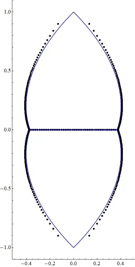

First it appears that the zeros are symmetric about the line $x=-1/2$, and indeed the polynomials
$$ F_p(z) = S_p(z-1/2) $$
appear to have only even or only odd powers of $z$.
It seems that the zeros not on the real axis grow on the order of $p/(2\pi)$. Numerically they have the same limiting behavior as the zeros of the partial sums of the sine and cosine series (see this paper [PDF]) as well as the partial sums of the Bessel functions (see this preprint).
Below is a plot of the zeros of $F_p\left(\frac{p}{2\pi}z\right)$ for $p=400$, along with the modified Szegő curve
$$ \begin{align} &\left\{z \in \mathbb{C} \,\colon \Im(z) \geq 0,\,\,\, |z| \leq 1, \,\,\,\text{and}\,\,\, \left|ze^{1+iz}\right| = 1 \right\} \\ &\qquad \cup \,\left\{z \in \mathbb{C} \,\colon \Im(z) \leq 0,\,\,\, |z| \leq 1, \,\,\,\text{and}\,\,\, \left|ze^{1-iz}\right| = 1 \right\} \\ &\qquad \cup \,\left\{x \in \mathbb{R} \,\colon -1/e \leq x \leq 1/e \right\} \end{align} $$
in blue.
There is possibly a connection to the zeros of the Bernoulli polynomials $B_p(x)$ as a result of the fact that
$$ S_p(z) = \frac{B_{p+1}(z+1) - B_{p+1}(0)}{p+1}. $$
You may wish to take a look at Karl Dilcher's memoir Zeros of Bernoulli, Generalized Bernoulli, and Euler Polynomials and this paper by John Mangual.
