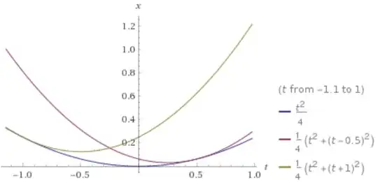

Using the method of characteristics, one writes
  • $\frac{\text d t}{\text d s}=1$. Letting $t(0) = t_0$ gives $t = s + t_0$.
  • $\frac{\text d u}{\text d s}=1$. Letting $u(0) = \frac{1}{2} t_0$ gives $u = s + \frac{1}{2} t_0$.
  • $\frac{\text d x}{\text d s}=u$. Letting $x(0) = \frac{1}{4} {t_0}^2$ gives $x = \frac{1}{2}s^2 + \frac{1}{2} t_0 s + \frac{1}{4} {t_0}^2$.
The parameter $s$ is eliminated by injecting $s = t-t_0$ in the expression $x(s)$ of the characteristic curves. The latter becomes $x = \frac{1}{4}\big( t^2 + (t-t_0)^2\big)$, which is inverted as $t_0 = t \pm \sqrt{4x - t^2}$. If we inject the equation of the characteristic curves in the expression of $t_0$, we get $t_0 = t \pm |t-t_0|$. Therefore, the top sign ($+$) corresponds to times $t\leq t_0$, while the bottom sign ($-$) corresponds to times $t\geq t_0$. The curves in the $x$-$t$ plane are shown below for several values of $t_0$ (the blue line marks the boundary where the data is imposed).
characteristics
For example, let us consider the point $(x,t) = \big({5}/{32}, -{1}/{4}\big)$ of the $x$-$t$ plane. From the expression of $t_0$, we find the value $t_0 = {1}/{2}$ which satisfies $t<t_0$, and the value $t_0 = -1$ which satisfies $t>t_0$. Hence, two characteristic curves are passing through this point. The first one carries the value $u = t - t_0/2 = -1/2$. The second one carries the value $u = t - t_0/2 = 1/4$. Both solutions $$ u(x,t) = \tfrac{1}{2} \big( t \mp \sqrt{4x - t^2} \big) ,\qquad 4x - t^2\geq 0 $$ exist simultaneously. The classical solution deduced from the characteristics is bi-valued everywhere in the region $4x - t^2 > 0$. The problem is not well-posed in the sense of existence and uniqueness.
