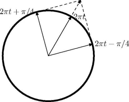

If you draw the situation on the unit circle, then $\sin\varphi$ is the x-coordinate of the point corresponding to the angle $\varphi$. The points $2\pi t-\pi/4$ and $2\pi t+\pi/4$ have right angle between them and $2\pi t$ is exactly in the middle.
So from the right triangle below you see that the sum of the vectors corresponding to $2\pi t-\pi/4$ and $2\pi t+\pi 4$ has the same direction as the vector corresponding to $2\pi t$ and the length is $\sqrt2$. The sum $\sin(2\pi t-\pi/4)+\sin(2\pi t+\pi/4)$ is the x-coordinate of this vector, and it is equal to $\sqrt2\sin 2\pi t.$
The same argument gives $\cos(2\pi t-\pi/4)+\cos(2\pi t+\pi/4)=\sqrt2\cos 2\pi t.$
