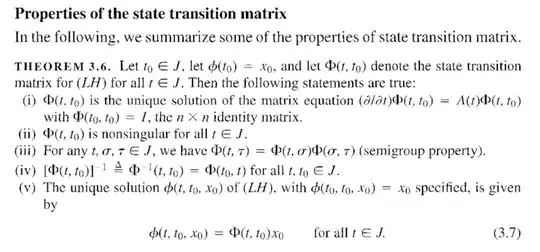

All 1st order linear ODEs have the property $$ f (a) f (b) = f (a+b) $$ Some call it the semigroup property$^\color{red}{\star}$ of the state transition matrix:
properties of the state transition matrix
Answering your questions:
  • You have the ODE $\dot y = y$, which is 1st order and linear. Hence, your $1 \times 1$ state transition matrix has the semigroup property. Arguably, this is more interesting in higher dimensions.
  • Exponential behavior (whether growth or decay) can be defined by the law $\dot x = \alpha x$, i.e., the rate of change at a certain time is directly proportional to the magnitude at that same time.
$\color{red}{\star}$ Panos Antsaklis, Anthony Michel, Linear Systems, Springer, 2006.
