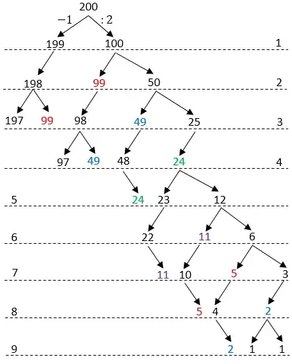

Working backwards, use the tree diagram and stop lagging branches (e.g. if $\color{red}{99}$ in step $3$ leads to $1$, then it takes one more operation than $\color{red}{99}$ in step $2$):
$\hspace{3cm}$enter image description here
