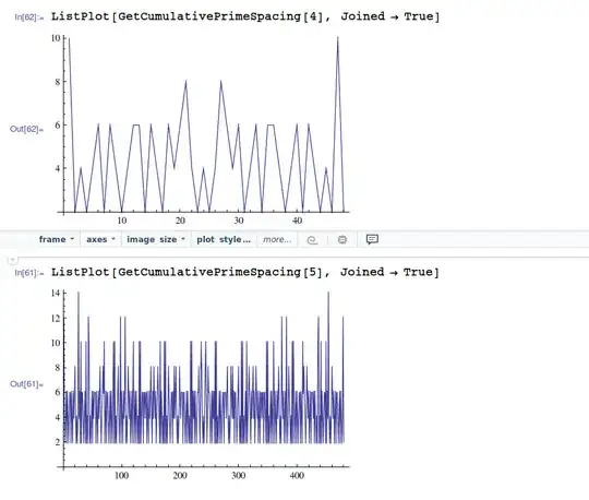

I am interested in this topic too, primarily prime sieve mathematics, which happens to tie itself up in reduced residue sets and all kind of other number theoretic topics.
To start off, lets look at the dRRS function on primorials, that is: the differences of a reduced residue system modulo primorials. The dRRS function would basically give us the gap sequence to hit numbers CoPrime to a primorial. It would enable us to get future primes, when folded by addition from 1.
For example, dRRS[Primorial1] is just {2}, if we start from 1 and continue adding 2, we will hit only odd numbers. Effectively, 2 eliminates half of all natural numbers from being prime.
dRRS[Primorial[2]] is {4,2} and allows us to skip any multiplies of BOTH 2 and 3, when folded from 1 by addition. That is, we would go from
$1\to5\to7\to11\to13\to17\to19\to23\to25$, etc.. Notice how we hit 25, that is 5 squared. This is very relevant. The dRRS function will allow us to get actual primes but only until the next prime squared.

Okay, well anyhow, I thought you might want to know that each population has a distinct closed formula equal to sums of products of offset primes. I have not figured out a generic way to generate these, I have only brute-forced them using Mathematica at the moment. But that is what I am looking at next in my search for truth.
Firstly, there are never any consecutive twins, quads, hextuplets, etc, etc ie. the count of {2,2} or {4,4} or {6,6} etc constellations, is always 0, for any dRRS of primorials.
2's and 4's have a count equal to Product[Prime[z] - 2, {z, 2, i}] ( you already know this )
All tuplets have the same count as their palindrome. That is, {2,4} and {4,2} will have equal counts. This is because the dRRS is palindromic itself
Illustrations: ListPlots of dRRS[Primorial[4]], dRRS[Primorial[5]]
the count of {2,4}s is Product[Prime[z] - 3, {z, 3, i}] the count of 6s is 2*Product[Prime[z] - 2, {z, 2, i}] - 2*Product[Prime[z] - 3, {z, 3, i}]
It is clear, because of the partitioning and copying we discussed earlier, that the count of 6s can be derived from the count of constellations {2,4},{4,2}, 2s, and 4s. And so there is clearly a recursive formula that should be able to be derived for the count of any arbitrary constellation.
Again, here are the formulas I currently have, tested up to dRRS[Primorial[10]]
