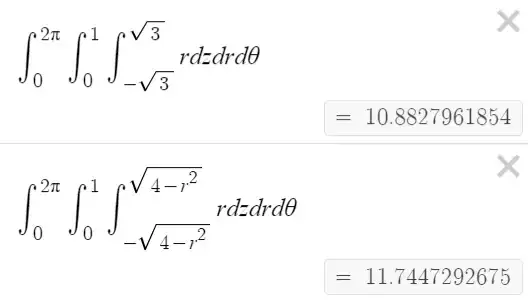

Find the volume of the solid that lies within both the cylinder $x^2+y^2=1$ and the sphere $x^2+y^2+z^2=4$.
I decided to use polar coordinates so that the cylinder equation becomes $r^2=1$ and the sphere becomes $r^2+z^2=4$.
Solving for $z$, I get the inequality $-\sqrt{4-r^2}\leq z\leq \sqrt{4-r^2}$. Since I know what $r^2$ is, I plug that in to get the inequality where $z$ is between $-\sqrt{3}$ and $\sqrt{3}$. Combining that to make a triple integral, I get:
$$\int_0^{2\pi}\int_0^1\int_{-\sqrt{3}}^\sqrt{3}r\,\mathrm{d}z\,\mathrm{d}r\,\mathrm{d}\theta$$
However, Slader has a different answer where they didn't plug in $\sqrt{3}$ into the bounds. Why does plugging in the value for $r^2$ make the calculation wrong? Isn't $r^2$ always $1$?

“Isn’t $r^2$ always 1?”
Yes, on the surface of the cylinder.
But you aren’t integrating on the surface of the cylinder. You’re integrating over a three-dimensional region, namely the one bounded by both the cylinder and the sphere. This region is described in cylindrical coordinates as the set with
$$r\in[0,1]$$ $$\theta\in[0,2\pi)$$ $$z\in\left[-\sqrt{4-r^2}, \sqrt{4-r^2}\right]$$
    Note that the integral you did, with $\pm\sqrt{3}$, just gives the volume of a cylinder, with height $2\sqrt{3}$. You left off the spherical caps. – symplectomorphic Feb 14 '19 at 20:20
No, $r$ is not always $1$. We're in the integral; $r$ is a variable we're going to integrate over later, and it doesn't have any fixed value.
The cylinder equation $r=1$ represents part of the boundary. It's certainly not true for every point inside the solid.
