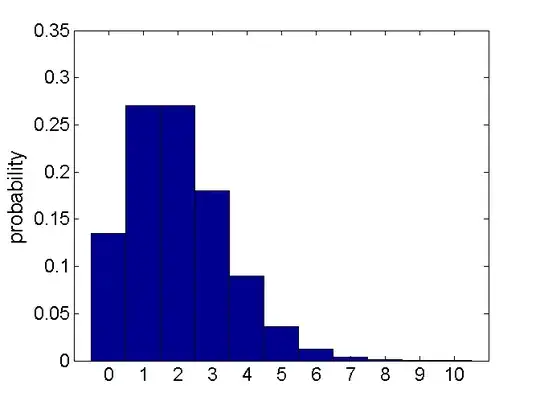

Consider a discrete case. PMF is the probability each value of random variable gets. So, for example, X ~ Poisson(2). I plot these probabilities (below), so I can say that I show the PMF of X. But on the other hand I show the distribution of X. For example, I can say whether the distribution I have is symmetrical or not. So, what is the difference between probability distribution and PMF terms (in discrete case)? Below I also bring the definitions from Wikipedia, but it is not helpful either.
Many thanks!

The word "distribution" gets thrown around loosely sometimes, which can cause confusion.
The distribution of a random variable $X$ is the function that takes a set $S \subset \mathbb R$ as input and returns the number $P(X \in S)$ as output. (Technically I should assume that $S$ is a "nice" subset of $\mathbb R$ in some sense, but let's not worry about that.) I think the Wikipedia article would be more clear if it just gave us this definition up front.
The probability mass function (PMF) of a random variable $X$ is the function that takes a number $x \in \mathbb R$ as input and returns the number $P(X=x)$ as output. If $X$ is a discrete random variable, then the PMF of $X$ is a convenient way to specify the distribution of $X$.
Here is one way to describe the relationship between the distribution of $X$ and the PMF of $X$, in the case where $X$ is a discrete random variable. Suppose that the possible values of $X$ are $x_1,x_2,\ldots$ If $f$ is the distribution of $X$, then $$ f(S) = \sum_{i : x_i \in S} P(X = x_i) $$ for any set $S \subset \mathbb R$.
littleO
  • 54,048
    Thanks. But is not the definition of PMF by itself exactly as you described for "distribution of a random variable X"? If not, how they are different? – John Dec 31 '18 at 14:34
    No, those definitions are not the same. For example, the PMF of $X$ takes a number as input, but the distribution of $X$ takes a set of numbers as input. – littleO Dec 31 '18 at 14:38
    Thank you a lot, for clarification. But I am still a bit confused regarding your statement "the distribution of X takes a set of numbers as input". Suppose I flip a coin twice, X is number of tails. My PMF is: 0: 1/4, 1: 1/2, 2, 1/4. So, for each value X (0,1,2,) the PMF returns the P(X=x). How will look the distribution function? It would help you can update your answer. Thanks! – John Dec 31 '18 at 14:51
    Let $f$ be the distribution of the random variable $X$ that you mentioned. Then for example, if $S = (-7,1.3)$ (that is, $S$ is the open interval from $-7$ to $1.3$), then $f(S) = 3/4$. We could attempt to describe $f$ more explicitly but I'm not sure that it would be useful. The definition of $f$ is just that $f(S) = P(X \in S)$ for any set $S \subset \mathbb R$. – littleO Dec 31 '18 at 14:58
    OK. I see. Thanks a lot. – John Dec 31 '18 at 15:03
