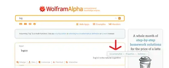

Additionally, if you search for the term that you need more information on, in this case log, you can get the definition & documentation by hovering over the shortened definition in the bottom corner:
The Wolfram|Alpha reference, provides amazing insight into these type of questions.
