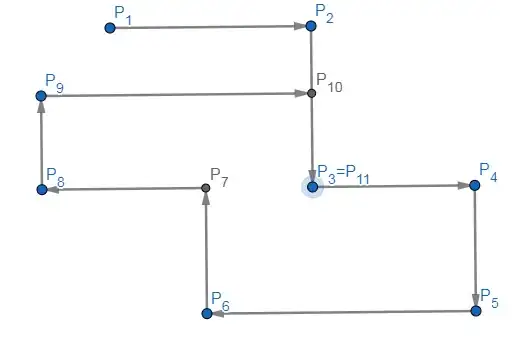

Pick any point $P_1$ and draw a horizontal line through it extending towards either right or left (which ever side has at least $1$ point). Let $P_2$ be the first point it meets. $P_2$ must exist as all rows and columns have an even number of elements. Now draw a vertical line through $P_2$, extending towards either up or down (which ever side has at least $1$ point), and let $P_3$ be the first point it meets. Draw a horizontal line through $P_3$ and so on. Let $j$ be the least number such that $P_j=P_i$ for some $i<j$.($j=11$ in the figure) If $i$ and $j$ have the same parity(for $i=3$ in the figure), $P_iP_{i+1}$ and $P_{j-1}P_{i}$ are perpendicular. If not (if for example, $i=2$ in the figure), increment $i$ by 1. Then, for the new $i$, $P_iP_{i+1}$ and $P_{j-1}P_{i}$ are perpendicular.
Here is a diagram for illustration. Diagram
Let $S'=\{P_i,P_{i+1},...,P_{j-1}\}$. We apply induction hypothesis on $S-S'$ and colour $P_i$ blue, $P_{i+1}$ red, $P_{i+2}$ blue and so on till $P_{j-1}$ is coloured Red.
