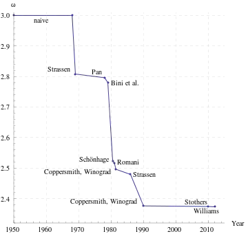

The Wikipedia page https://en.wikipedia.org/wiki/Matrix_multiplication_algorithm#Sub-cubic_algorithms shows how the fast known asymptotic algorithm has evolved through time:
