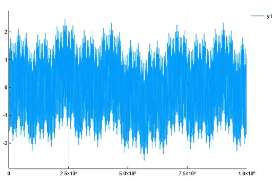

I added a Figure of the RHS of (5) up to $N=10^6$ which doesn't look anything like $\log$, so either the numbers are just too small or I dont why it has to be $\log$.
