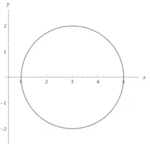

To begin with, none of the points are on the actual curves, i.e
a) $\gamma(t)=3+2e^{it}, 0\leq t\leq 2pi$ is
So $z_0=2$ is inside the disk surrounded by $\gamma$ ($0$ isn't). In this case Cauchy's integral formula applies $$f(z_0)=\frac{1}{2\pi i } \int\limits_{\gamma}\frac{f(z)}{z-z_0}dz \tag{1}$$ where $f(z)=\frac{e^{z^2}}{z}$. Or $$\int\limits_{\gamma}\frac{e^{z^2}}{z(z-2)}dz=2 \pi i \cdot f(2)=\pi i e^4$$

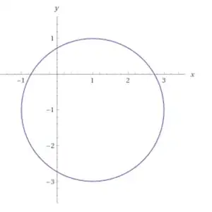

b) $\gamma(t)=1-i+2e^{it}, 0\leq t\leq 2pi$ is
So $z_0=-i$ is inside the disk surrounded by $\gamma$ ($i$ isn't). Cauchy's integral formula $(1)$ applies again for $f(z)=\frac{z^2-1}{z-i}$. Or $$\int\limits_{\gamma}\frac{z^2-1}{z^2+1}dz=2 \pi i \cdot f(-i)=2 \pi i \frac{-1-1}{-i-i}=2 \pi$$
