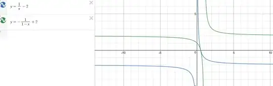

Consider $g:(0,1) \rightarrow \mathbb{R}$ enter image description here
$g(x)= \begin{array}{cc} \{ & \begin{array}{cc} \frac{1}{x} - 2 & x < \frac{1}{2} \\ \ \frac{-1}{1-x} + 2 & x >= \frac{1}{2} \\ \end{array} \} \end{array} $ enter image description here

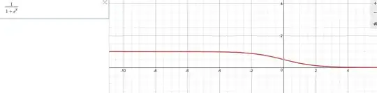

and define $f: \mathbb{R} \rightarrow (0,1)$
$f(x)=\frac{1}{1+e^x}$ Is there a bijective map from $(0,1)$ to $\mathbb{R}$?
$g o f$ is surjective but $f$ is not.
