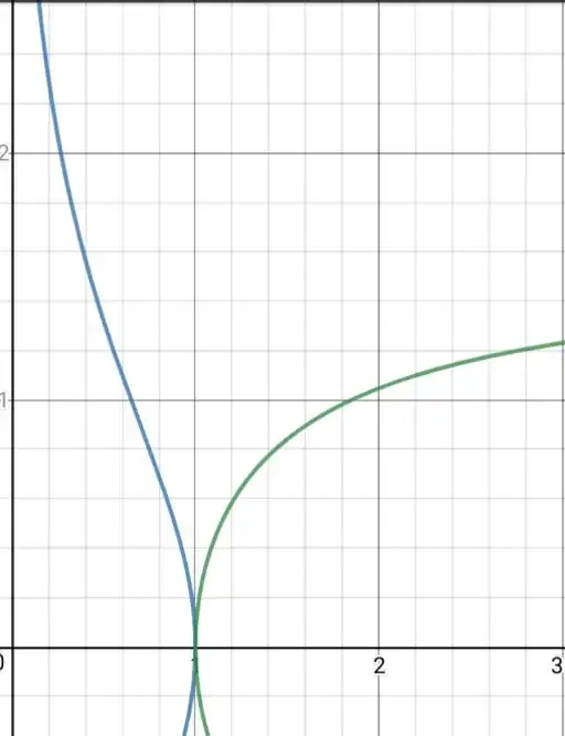

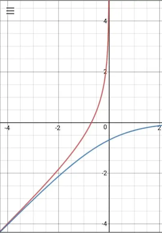

Images for Case $n=2$ (the original subject of the post)
enter image description hereenter image description here
The upper diagram shows the functions $y=\operatorname{asech}x$ & $y=\operatorname{asec}x$, and the lower the integrals of these along the $y$-axis $x=\operatorname{acos}\operatorname{sech}y$ & $x=\operatorname{acosh}\operatorname{sec}y$.

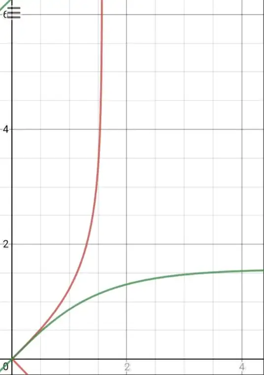

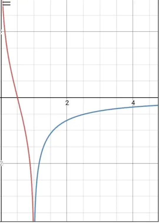

Images for Case $n=1$
The upper diagram shows the functions $y=\operatorname{ln}((1-x)/x)$ & $y=\operatorname{ln}((x-1)/x)$, and the lower the integrals of these along the $y$-axis $x=-\operatorname{ln}(e^{-y}+1)$ & $x=-\operatorname{ln}(e^{-y}-1)$.
