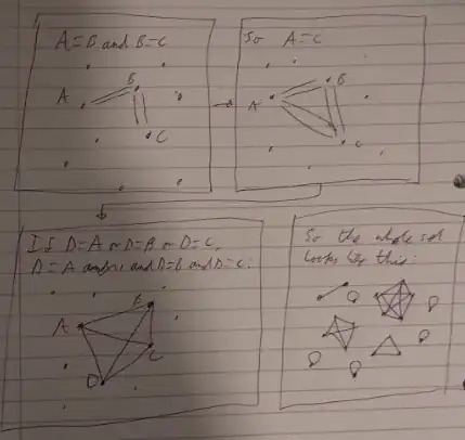

Here's a visual explanation.
Note that the nodes in the first three panels should have had edges to themselves as well (from reflexivity of equivalence relations).

  • I have no idea what your drawing means, but it looks pretty – étale-cohomology Nov 11 '18 at 01:02
  • I like this picture. It illustrates the type of graph that an equivalence relation defines. Namely, because an equivalence relation is symmetric, the graph is undirected. Because it is reflexive, every node has an edge to itself (the loops in the picture). Because it is transitive, every connected component is a complete graph. – Cooler Paradox Sep 16 '22 at 01:47
