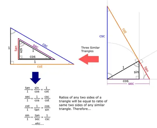

Not taking "credit" for the answer - but my own visual summary of the good answers provided:
Brad
