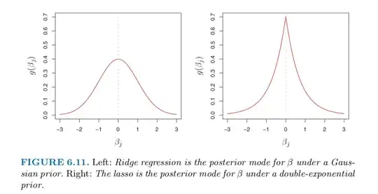

It turns out that ridge regression and the lasso follow naturally from two special cases of $g$:
  • If $g$ is a Gaussian distribution with mean zero and standard deviation a function of $\lambda$, then it follows that the posterior mode for $\beta$ $-$ that is, the most likely value for $\beta$ , given the data—is given by the ridge regression solution. (In fact, the ridge regression solution is also the posterior mean.)
  • If $g$ is a double-exponential (Laplace) distribution with mean zero and scale parameter a function of $\lambda$, then it follows that the posterior mode for $\beta$ is the lasso solution. (However, the lasso solution is not the posterior mean, and in fact, the posterior mean does not yield a sparse coefficient vector.)

However, it would be preferred if we can add probability interpretation for the minimizer, this is why assume some distribution on y and parameters.
Now assume that $y|X,\beta \sim N(X \beta, \sigma I)$, then Least square minimizer is the Maximum likelihood estimator.
Further if assume $\beta \sim N(0, I)$, then rigde minimizer is the maximum a posterior probability (MAP) estimator while assume $\beta$ laplace distribution, then lasso minimizer is also the maximum a posterior probability (MAP) estimator.
In summary, we assume distribution on y and $\beta$ to give proability interpretation of the minimizer, However, these assumptions not necessarily hold in reality. Just for interpretation purpose only.
