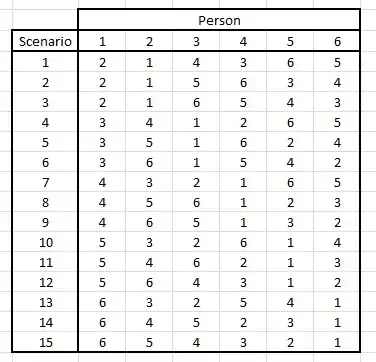

But handshake scenarios do not in general fulfill the bolded part above. The only instances I found where this is true is with $n=2$ or $n=4$. For $n=6$, for example, we have the following list of scenarios at $t=0$:
We see that any of the $15$ scenarios gives an equal probability for everyone of shaking hands with anyone not-formerly-shaken. Let's randomly select a scenario (green) and then exclude those scenarios which are no longer possible (blue):
We see that the remaining scenarios still fulfill the bolded part above. I.e. the remaining choices are equally distributed for everyone. So far, so good. Let's then select another scenario:
We now see that the remaining scenarios are not evenly distributed. In all scenarios, one person is twice as likely to be selected as the others.
The above is also true for $n=8$, which breaks down at the first round. I suspect it is true for all $n \gt 4$, though I can't prove it.
In short, the main question was very vague and probably the best response would have been to ask a lot of clarifying questions.
