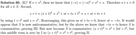

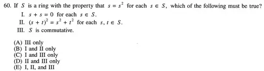

Ian Coley's approach is to prove $(I)$ and $(I) \implies (II) \implies (III)$
In proving $(I)$, how do we prove $$(-s)^2=s^2$$ without commutativity (but with $s=s^2$, if need be, and of course without $s+s=0$)?

$-s$ is the additive inverse of $s$, so $s+(-s)=0$. Then $$0=s0=s(s+(-s))=s^2+s(-s).$$ Also $$0=0(-s)=(s+(-s))(-s)=s(-s)+(-s)^2.$$ Therefore $s^2$ and $(-s)^2$ are both the inverse of $s(-s)$ in the commutative group of $R$ under addition: $s^2=(-s)^2$.
But, a better approach to I, is to note that in addition to $s^2=s$ we also have $(s+s)^2=s+s$, that is $s^2+s^2+s^2+s^2=s+s$. Then $s+s+s+s=s+s$ and cancelling $s+s$ in the Abelian group of $R$ under addition gives $s+s=0$.
