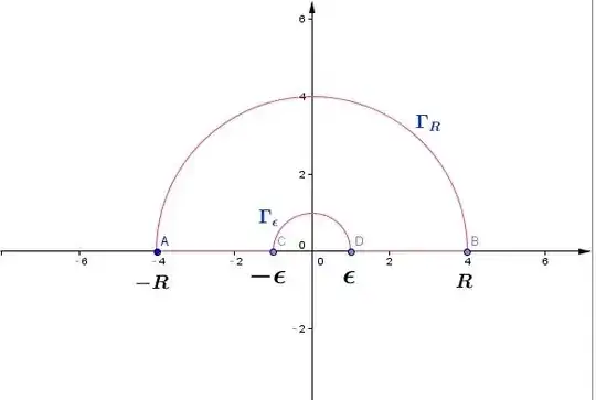

In this post, I want to discuss another way to computer it. since$$\int_0^{+\infty}\frac{\sin x}{x}\text{d}x=\frac{1}{2i}\int_{-\infty}^{+\infty}\frac{e^{ix}-1}{x}\text{d}x$$ this fact inspire me to consider the complex integral:$$\int_{\Gamma}\frac{e^{iz}-1}{z}\text{d}z$$ Integral path
and $\Gamma$ is the red path in the above figure, with counter-clockwise orientation, by Cauchy's theorem, we have $$\int_{\Gamma}\frac{e^{iz}-1}{z}\text{d}z=0$$ the above integral can be written as:$$\int_{-R}^{-\epsilon}\frac{e^{ix}-1}{x}\text{d}x+\int_{\Gamma_{\epsilon}}\frac{e^{iz}-1}{z}\text{d}z+\int_{\epsilon}^{R}\frac{e^{ix}-1}{x}\text{d}x+\int_{\Gamma_{R}}\frac{e^{iz}-1}{z}\text{d}z$$ Let $R\rightarrow +\infty$ and $\epsilon \rightarrow 0$, we have: $$\int_{-R}^{-\epsilon}\frac{e^{ix}-1}{x}\text{d}x+\int_{\epsilon}^{R}\frac{e^{ix}-1}{x}\text{d}x \rightarrow \int_{-\infty}^{+\infty}\frac{e^{ix}-1}{x}\text{d}x=2i\int_0^{+\infty}\frac{\sin x}{x}\text{d}x$$ and $$\int_{\Gamma_{\epsilon}}\frac{e^{iz}-1}{z}\text{d}z=\int_\pi^0\frac{e^{i\epsilon e^{i\theta}}-1}{\epsilon e^{i\theta}}i\epsilon e^{i\theta}\text{d}\theta=i\int_\pi^0(\cos(\epsilon e^{i\theta})+i\sin(\epsilon e^{i\theta})-1)\text{d}\theta \rightarrow 0$$ as $\epsilon \rightarrow 0$
so I am expecting that:$$\int_{\Gamma_{R}}\frac{e^{iz}-1}{z}\text{d}z=-i\pi$$ when $$R \rightarrow +\infty$$ but I can't find it. Could you help me? Thanks very much.

    $\frac{e^{iz}}{z}$ can be integrated, therefore the integral around the full circle is 0. $\int_{K_R(0)}\frac{1}{z}dz=2\pi i$. Now argument that the functions are symmetric. This would be my approach, not sure about it however – CBenni Feb 04 '13 at 13:28
    $|\exp(i R e^{i\theta})| \le \exp(-R\sin\theta)$ on $\Gamma_R$. – achille hui Feb 04 '13 at 13:34
    How are you getting an integrand of $\frac{e^{iz}-1}{z}$? Isn't $\int_{-\infty}^\infty\frac{\sin z}{z}dz$ the imaginary part of $\int_{-\infty}^\infty\frac{e^{iz}}{z}dz=\pi i$? – Ben West Feb 04 '13 at 13:42
    @BenW: I think he means $\frac{1}{2i}\Im{\int_{-\infty}^{+\infty}\frac{e^{ix}-1}{x}\text{d}x}$. And I think his point is that $\frac{1}{2i}\int_{-\infty}^{+\infty}\frac{e^{ix}}{x}\text{d}x$ diverges. – Ron Gordon Feb 04 '13 at 14:16
    Nope, the point is $|e^{iz}| \to 0$ as $\Im z \to +\infty$. If one use $\sin z$ in the integrand, the integrand will blow up on $\Gamma_R$. – achille hui Feb 04 '13 at 14:44
    To satisfy Fubini's theorem, the iterated integral must converge absolutely or the integrand must always be positive. Neither conditions are satisfied in this case. But you can get around that by integrating by parts first. – Random Variable Feb 04 '13 at 16:00
There is the formula $$ \mathrm{pr.v.}\int_{-\infty}^\infty R(x)e^{ix}dx=2\pi i\sum_{y>0}\operatorname{Res} R(z)e^{iz}+\pi i\sum_{y=0}\operatorname{Res} R(z)e^{iz} $$ where the LHS is the principal value, and the RHS is the sum of the residues in the upper half plane, and along the real axis, respectively. This is under the assumption that all poles on the real axis are simple, and $R(\infty)=0$. This is found in Section 5.3, page 158 of Ahlfor's Complex Analysis.
In fact, your question is his first example. Since $\frac{e^{iz}}{z}$ has a single simple pole at $0$ with residue $1$, applying the above formula shows $$ \mathrm{pr.v.}\int_{-\infty}^\infty\frac{e^{ix}}{x}dx=\pi i. $$ Separating into real and imaginary parts, we find $$ \int_{-\infty}^\infty\frac{\sin x}{x}dx=\pi $$ where we drop the principal value since the integral converges. Since $\displaystyle\frac{\sin x}{x}$ is an even function, it follows that $$ \int_0^\infty\frac{\sin x}{x}dx=\frac{\pi}{2}. $$

Way too messy: just take
$$f(z):=\frac{e^{iz}}{z}\;\;,\;\;C_R:=[-R,-\epsilon]\cup \gamma_\epsilon\cup [\epsilon, R]\cup \gamma_R\,\,,\,\,0<\epsilon<<R\,\,,\,\,\epsilon\,,\,R\in\Bbb R\,$$
$$\gamma_h:=\{z\in\Bbb C\;;\;z=he^{it}\,\,,\,0\le t\le \pi\,\,,\,0<h\in\Bbb R\}$$
We use the lemma, and specially its collorary, in the first answer here , to get:
$$\lim_{\epsilon\to 0}\int\limits_{\gamma_\epsilon}f(z)\,dz=\pi i$$
Also
$$\left|\int\limits_{\gamma_R}f(z)\,dz\right|\le \max\frac{e^{-R\sin t}}{R}\pi R\xrightarrow[R\to\infty]{}0$$
so that by Cauchy's Integral Theorem
$$0=\lim_{R\to\infty}\oint f(z)\,dz=\int\limits_{-\infty}^\infty\frac{e^{ix}}{x}dx-\pi i+0\Longrightarrow$$
$$\int\limits_{-\infty}^\infty\frac{\cos x+i\sin x}{x}dx=\pi i$$
Now just compare real and imaginary parts, and take into account that our integrand is an even function...
