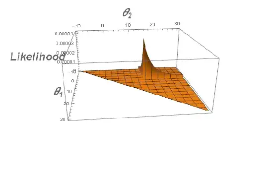

Sometimes a picture will tell you that the maximum likelihood estimates don't occur when derivatives are zero. Here is a plot of the likelihood surface for your data and model:
Likelihood surface

  • oh yeah, what program did you do that in @JimB Can you post the code? – Bucephalus Oct 05 '18 at 16:19
  • I read your profile, mathematica for sure. @JimB Is mathematica free? – Bucephalus Oct 05 '18 at 16:20
    Mathematica is not free. You can google it to look for a price (as I suppose putting explicit advertisements here is frowned upon). I'll post the code later today when I have time. – JimB Oct 05 '18 at 16:32
  • It's ok, you don't have to. I do not think I would pursue it if it isn't free. Thanks @JimB – Bucephalus Oct 05 '18 at 16:33
  • Such a figure can also be constructed in R which is free (of course, "free" does not include the time it takes to learn it). (And many other "free" software titles will also create such figures.) – JimB Oct 05 '18 at 16:36
  • Yep, i'm learning R. I'm not that advanced yet. I will stick with R for sure. @JimB – Bucephalus Oct 05 '18 at 16:38
  • Sorry @JimB, Michael's answer is more relevant to the question. Cheers. – Bucephalus Oct 05 '18 at 18:26
  • No need to be sorry. My "answer" was just more of a comment to help bring home some of @StubbornAtom 's comments. – JimB Oct 05 '18 at 19:55
