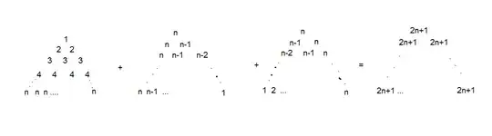

There are a few ways to do this. I think that this one is intuitive. enter image description here
In the first triangle, the sum of $i^{th}$ row equals $i^2$
The next two triangles are identical to the first but rotated 120 degrees in each direction.
Adding corresponding entries we get a triangle with $2n+1$ in every entry. What is the $n^{th}$ triangular number?
$3\sum_\limits{i=1}^n i^2 = (2n+1)\frac {n(n+1)}{2}\\ \sum_\limits{i=1}^n i^2 = \frac {n(n+1)(2n+1)}{6}$
To find: $\sum_\limits{i=1}^{n+1} i^2 $, sub $n+1$ in for $n$ in the formula above.
$\sum_\limits{i=0}^n 2(i + 1)^2 = \frac {(n+1)(n+2)(2n+3)}{3}$
