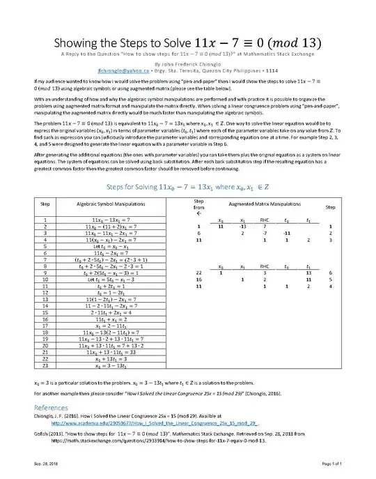

The problem 11x − 7 ≡ 0 (mod 13) is equivalent to 11 x0 − 7 = 13 x1 where x0, x1 ∈ . One way to solve the linear equation would be to express the original variables (x0, x1) in terms of parameter variables (t0, t1) where each of the parameter variables take on any value from . To find such as expression you can judiciously introduce the parameter variables and corresponding equation one at a time.
After generating the additional equations (the ones with parameter variables) you can take them plus the original equation as a system on linear equations. The system of equations can be solved using back substitution. After each back substitution step if the resulting equation has a greatest common factor then the greatest common factor should be removed before continuing.
The PDF document "Showing the Steps to Solve 11x − 7 ≡ 0 (mod 13)" applies these ideas in a step-by-step fashion. The following diagram is a snap shop of the PDF page:
