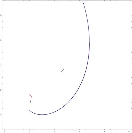

Attached a plot showing the solutions
$$ S_1\to 2 \tan ^{-1}\left(\frac{x+y-3}{x-y-1}\right)=\log \left(\frac{x^2-4 x+y^2-2 y+5}{2 (x-2)^2}\right)+2 \log (x-2)+C_0\\ S_2\to \tan ^{-1}\left(\frac{y-1}{x-2}\right)-\frac{1}{2} \log \left(\frac{(y-1)^2}{(x-2)^2}+1\right)=\log (x-2)+C_1 $$
with $C_0=0, C_1 = -1.13$
I hope this helps.
In red $S_1$ and in blue $S_2$
Cesareo
