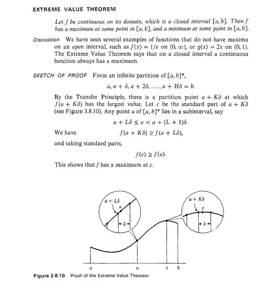

I am reading Keisler's Elementary Calculus (which can be downloaded here). I am having trouble understanding his proof sketch of Extreme Value Theorem and how he is applying the Transfer Principle.
For reference, he defines the "Transfer Principle" as:
Every real statement that holds for one or more particular functions holds for the hyperreal natural extension of these functions.
On page 164 (using left corner numbering) of the book he provides the following "sketch":
Extreme Value
I understand the counter examples and I am able to understand the issues with them using standard tools. I don't understand, however, how one can immediately utilize the Transfer Principle. It is not immediately obvious to me that "there is a partition point $a + K\delta$ at which $f(a + K\delta)$ has the largest value."
To elaborate, the proof seems circular. In trying to to "expand" the sketch to be more precise. I ended up writing instead of:
By the Transfer Principle, there is a partition point $a + K\delta$ at which $f(a + K\delta)$ has the largest value.
To:
Applying the Transfer Principle to the Extreme Value Theorem we see that the Extreme Value holds for hyperreals as well. Hence, there is a partition point $a + K\delta$ at which $f(a + K\delta)$ has the largest value.
But this relies on a proof of the Extreme Value Theorem for reals.

For me the problem here is that the statement Keisler gives of the transfer principle doesn't quite fit with how it is being used. You might want to look at a more formal source to clarify exactly what transfer says (try Goldblatt, or https://en.wikipedia.org/wiki/Transfer_principle and the references it cites).
Here transfer is being applied to the statement "if $n$ is a natural number and $s_1,\ldots, s_n$ are reals then $\{s_1,\ldots,s_n\}$ has a maximum." Transfer (in its full form - not necessarily in the way Keisler states it) tells you that this applies for $n \in \mathbb{N}^*$ too, which is exactly what is needed in the proof.
This can seem confusing if you think of nonstandard natural numbers as "infinitely large," because it is certainly not true that an infinite subset of $\mathbb{R}^*$ has to be bounded. This application of transfer tells us only that if $\nu$ is any natural number, even a nonstandard one, then every sequence $s_1,\ldots, s_\nu$ is bounded.
It is helpful to work through an example of a discontinuous unbounded function on a compact interval, to see why Keisler's argument wouldn't apply to that. Let's take $f(0)=0$ and $f(x)=1/x$ for $x>0$, so that $f: [0,1] \to \mathbb{R}$ is unbounded. We start by picking a partition of $[0,1]$ with evenly spaced points $0,1/H,2/H,\ldots, (H-1)/H, 1$, where $H$ is an "infinitely large" natural number. There is indeed a partition point at which $f$ is maximal, namely $f(1/H)=H$. The standard part of $1/H$, which gets called $c$ in Keisler, is 0. But you can't get any relationship betweeen $f(c)$ and $f(1/H)$, even though $c$ and $1/H$ are infinitely close, because $f$ is not continuous at 0. This means the argument breaks down, as it must.

  • @ParamanandSingh "Infinitely many" is misleading here: they are indexed by a nonstandard natural number (I prefer "illimited"). The argument does not tell you anything about an arbitrary function - how would you get a relation between $f(c)$ and $f(a+K\delta)$ without continuity? – Matthew Towers Sep 24 '18 at 14:22
  • Well the argument does use continuity to link $f(c) $ and $f(a+K\delta) $, but even if $f$ is discontinuous we can apply standard part to $f(a+K\delta) $ to get a real number $M$. Discontinuity may prevent us to write $M=f(c) $ but otherwise the argument does imply that the range is bounded. – Paramanand Singh Sep 24 '18 at 14:28
  • @ParamanandSingh this isn't correct - why would there be any relation between $M$ and the values $f$ takes between partition points? Consider the example of $f(0)=0$ and $f(x)=1/x$ for $x>0$, on the interval $[0,1]$... – Matthew Towers Sep 24 '18 at 14:35
  • I know what happens in the real number system. The function in your comment is unbounded. The argument of Keisler nowhere tries to show that $f(a+K\delta) $ is a finite hyperreal. It may be an infinite hyperreal also like the case of function in your comment. – Paramanand Singh Sep 24 '18 at 14:39
    @ParamanandSingh Keisler's argument does tell you that $f(a+K\delta)$ is finite: it is infinitely close to $f(c)$ (by continuity!). – Matthew Towers Sep 24 '18 at 14:46

Let me propose a different interpretation of transfer (in the formulation suggested by m_t_) for the Intermediate Value Theorem.
Consider the following "standard" argument about ordinary real numbers. For all $n \in \mathbb{N}$, it is possible to partition $[a,b]$ into $a, a+\frac{b-a}{n}, \ldots, a+n\frac{b-a}{n}=b$. Since there is a finite number of partition points (they are $n+1$), it is well-defined the maximum among the values $f(a), f\left(a+\frac{b-a}{n}\right), \ldots, f(b)$.
Recall that, by transfer, finite and $^\ast$finite sets satisfy the same properties. As a consequence, you can always pick the biggest element of a $^\ast$finite set. Hence, transfer entails also that for all $n \in\ \! ^\ast\mathbb{N}$ the number $$\max\left\{ f(a), f\left(a+\frac{b-a}{n}\right) , \ldots, f\left(a+n\frac{b-a}{n}\right)=f(b) \right\}$$ is well-defined for every partition of $^\ast[a,b]$ into $n$ equal parts. In other words, you are proving the Extreme Value Theorem by applying transfer to the statement "every finite set has a maximum element", and not to the Extreme Value Theorem for real numbers.
Let now $n \in\ \! ^\ast\mathbb{N}$ be infinite, and let $$f\left(a+K\frac{b-a}{n}\right) = \max\left\{ f(a), f\left(a+\frac{b-a}{n}\right) , \ldots, f\left(a+n\frac{b-a}{n}\right)=f(b) \right\}.$$ (What I call $\frac{b-a}{n}$ is the infinitesimal $\delta$ in the original proof by Keisler). Define $c=\ \!^\circ\left(a+K\frac{b-a}{n}\right)$. By continuity of $f$ you have that $^\circ\left(^\ast f\left(a+K\frac{b-a}{n}\right) \right) = f(c)$. From here onward, it is possible to follow the original proof by Keisler.
