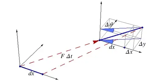

One might wonder if the analysis above is a little too loose. One can see what's going on in this figure:
Flow of two points
The points $(x,y,z)$ and $(x+dx,y,z)$ on the left flow in a given time $\Delta t$ to two points $(x',y',z')$ and $(x'+dx+\Delta x,y'+\Delta y,z'+\Delta z)$ on the right. The relative change in position is given by $$(\Delta x,\Delta y,\Delta z) \approx \left( {\partial F_1 \over \partial x}\;dx,\, {\partial F_2 \over \partial x}\;dx,\, {\partial F_3 \over \partial x}\;dx \right)\; \Delta t = \left( {\partial \over \partial x} {dx \over dt},\, {\partial \over \partial x} {dy \over dt},\, {\partial \over \partial x} {dz \over dt} \right) \;dx \;\Delta t$$ The amount rotation $\Delta\theta$ in the time $\Delta t$ about ${\bf k}$ is given by $$\tan \Delta\theta = {\Delta y \over dx + \Delta x}$$ As $\Delta t \rightarrow 0$, $dx$ is fixed; but $\Delta x \rightarrow 0$, $\Delta y \rightarrow 0$ and $\tan \Delta\theta \sim \Delta\theta \rightarrow 0$. Thus $${\Delta\theta \over \Delta t} \sim {\tan \Delta\theta \over \Delta t} \sim {\Delta y/\Delta t \over dx} \rightarrow {\partial \over \partial x} {dy \over dt}\,.$$ The partial derivative is evaluated at some point $(x^*,y,z)$ between $(x,y,z)$ and $(x+dx,y,z)$. As $dx \rightarrow 0$, $(x^*,y,z) \rightarrow (x,y,z)$, and the angular rate becomes the term in the formula for the curl.
Curl and the rate of rotation
We found the ${\bf k}$ component of the curl to be the sum of two rates of rotation $${\rm curl}\; {\bf F} \cdot {\bf k} ={d\theta_1 \over dt} + {d\theta_2 \over dt} = { \left({\partial \over \partial x} {dy \over dt} \right) + \left( - {\partial \over \partial y} {dx \over dt} \right)}\,.$$ The other components may be derived similarly. Cartesian coordinate axes may be chosen arbitrarily. At a point on a given surface with unit normal ${\bf n}$, we may choose the coordinate axes so that ${\bf k} = {\bf n}$ (with ${\bf i}, {\bf j}$ being whatever mutually orthogonal unit vector we please). Thus the component of the curl ${\rm curl}\; {\bf F} \cdot {\bf n}$ is the sum of two rates of rotation independent of the choice of ${\bf i}, {\bf j}$.
One way to think of it is that the curl is twice the average of two rates of rotation. Why twice? Why the average? Plausible arguments: (1) It turns out that way. :) (2) The bisector of the angle formed by $(x,y+dy,z)$--$(x,y,z)$--$(x+dx,y,z)$ rotates at the average rate. (3) The circulation/area has a factor of 2 in it when $S$ is a disk or square, when viewed in a certain way: Let $S$ be a disk or square centered at $(x,y,z)$ whose perimeter is a radius/distance $R$ from the center. If we write the circulation/area in the form $${\rm curl}\; {\bf F} \cdot {\bf n} = {\int_{\partial S} {\bf F} \cdot dr \over \hbox{area}}= {(\bar{{F}})(\hbox{perimeter}) \over \hbox{area}} = {(\bar {F})(2\pi R) \over \pi R^2} \,\buildrel {\rm or} \over = \, {(\bar {F})(8R) \over 4R^2}= {2\,\bar {F} \over R}\,,$$ then the normal component of the curl is twice the mean circulation $\bar {F}$ over the radius of $S$. So for instance if a disk turns at an angular rate $\omega$, the velocity at the perimeter is a constant $\omega R$, which also equals $\bar {F}$. The circulation is $(\omega R)\,(2\pi R)$, and therefore the circulation/area is $2 \omega$, that is, twice the average rate of rotation.
