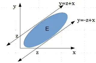

I need to find the PDF of $Z=|Y-X|$ given that $X,Y\sim exp(\lambda)$ and both independent.
What I did (I want to use the CDF and not convolutions):
$f_{X,Y}(x,y)=\cases{\lambda^2 e^{-\lambda(x+y)} & if $x,y \ge 0$\cr 0 & otherwise\cr}$
$F_{Z}(z)=P(-z \le Y-X \le z)=P(-z + X \le Y \le z + X)$
I chose $z$ as a fixed point, which results in this picture :
enter image description here $$ $$ So we're interested in set $E$ which collects all the sandwiched points, we need to integrate capturing them. What I claim is that $y \in [-z+x,z+x]$ and $x \in [0, \infty)$ $$F_{Z}(z) = \int\int_{E}f_{X,Y}(x,y)dydx=\int_{0}^{\infty}\int_{-z+x}^{z+x}f_{X,Y}(x,y)dydx$$
The result I got is a wrong one : $F_{Z}(z)=-\frac{1}{2}(e^{\lambda z}-e^{-\lambda z})$
Question : Are my intervals for $x,y$ false ?
Expected result : $f_{Z}(z) = \lambda e^{-\lambda z}$

Note that $f(x,y)=0$ for some of your integration region.
\begin{align} F_Z(z) &= \int_0^z \int_0^{z+x}f_{X,Y}(x,y) \, \, dydx + \int_z^\infty \int_{-z+x}^{z+x}f_{X,Y}(x,y) \, \, dydx \\ &= \int_0^z \int_0^{z+x}\lambda^2\exp(-\lambda(x+y)) \, \, dydx + \int_z^\infty \int_{-z+x}^{z+x}\lambda^2\exp(-\lambda(x+y)) \, \, dydx \\ \end{align}
Siong Thye Goh
  • 153,832
  • the first line with integrals would've been enough :), could you please explain when f(x,y) = 0 ? x and y are allowed to be only positive , right ? – Oleg Sep 19 '18 at 10:11
  • when at least one of them is not positive, the correponding density is $0$. Hence there is no point integrating over those places. If we integrate using $\lambda^2 \exp(-\lambda (x+y))$ over those region, then we are integrating its upper bound and we will get a higher value for the CDF there. – Siong Thye Goh Sep 19 '18 at 10:15
  • could you provide a small example ? say z = -100, x = 10 and y then will be negative ? but z can't be negatve – Oleg Sep 19 '18 at 10:19
  • we should only consider $z$ that are positive, otherwise, the CDF and pdf are $0$ at those points. – Siong Thye Goh Sep 19 '18 at 10:25
  • yes, exactly, so why do you say that f(x,y) = 0 for some of my integration region ? if I can get this one, then question is solved :) I'll be able then to understand why you split up your integration in such a way. – Oleg Sep 19 '18 at 10:27
  • I do not know what is your next step after you write down the region of integration. Did you replace $f_{X,Y}(x,y)$ by $\lambda^2 \exp(-\lambda (x+y))$? – Siong Thye Goh Sep 19 '18 at 10:33
  • yes , of course, but again I'm just trying to understand why did you split your integral over those regions (unlike me, I only took $y$ to be between $-z+x$ and $z+x$) – Oleg Sep 19 '18 at 10:37
