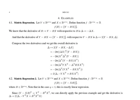

I am trying to understand why $\theta_{MLE} = (X^TX)^{-1}X^Ty$ for multinomial linear regression in which we have the Frobenius norm for $min||y-X\theta||^2$ Looking at this tutorial, I have hard time to followup with the steps. Is there a better link you could suggest or better way to derive? enter image description here
Also, using this solution, I have: $||X\theta-y||^2 = tr((X\theta-y)^T(X\theta-y))$ $= tr(\theta^TX^TX\theta - \theta^TX^Ty-y^TX\theta+y^Ty)$
differentiate wrt $\theta$: $\Delta_\theta f(\theta) = 2X^TX\theta-2X^Ty = 2X^T(X\theta-y)$
I am not sure how could I continue this to end up with $(X^TX)^{-1}X^Ty$
