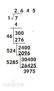

Okay, I searched through the answers, but none seems to mention this one: long quadratic root calculation.
From the name it is obvious that it resembles long division, like this:
$$ \begin{align} \sqrt{2.00\;00\;00\;00\;..} \end{align} $$
Notice how they are grouped into tuples. Now estimate the first digit, namely $1$:
$$ \begin{align} &~~~1.\\ 1&\sqrt{2.00\;00\;00\;00\;..}\\ &~~~1\\ &~~~\overline{1\,00} \end{align} $$
We calculate $1\times1=1$, write it down, and calculate the "remainder", just like divisions. Notice that we append 2 digits behind instead of 1.
Next, double the number on the top, and write it on the left of $1\,00$:
$$ \begin{align} &~~~1.\;*\\ 1&\sqrt{2.00\;00\;00\;00\;..}\\ &~~~1\\ 2*&\,\,|\overline{1\,00} \end{align} $$
Now we estimate the next digit, *. It is written both on the top and to the left. Of course, we know that it is 4, so:
$$ \begin{align} &~~~1.\;4\;\;\;*\\ 1&\sqrt{2.00\;00\;00\;00\;..}\\ &~~~1\\ 24&\,\,|\overline{1\,00}\\ &\,\,|\,\,\,\,96\\ &2\overline{8{*}|\,4\,00} \end{align} $$
We double the numbers on the top again to get $28*$, and repeat the process:
$$ \begin{align} &~~~1.\;4\;\;\;1\\ 1&\sqrt{2.00\;00\;00\;00\;..}\\ &~~~1\\ 24&\,\,|\overline{1\,00}\\ &\,\,|\,\,\,\,96\\ &2\overline{8{1}|\,4\,00}\\ &\,\,\,\,\,\,\,\,\,|\,2\,81 \end{align} $$
I found a picture, but not of $\sqrt{2}$:
sqrt(7)
This is extremely inefficient for computers, but great for manual calculation. After all, we don't do multiplication through fast Fourier transforms!
