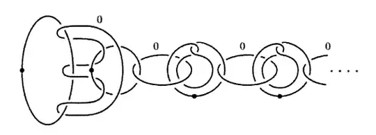

Here is a Kirby Diagram for an exotic $\mathbb R^4,$ taken from Gompf and Stipsicz's book, "4-Manifolds and Kirby Calculus." It's not given in the form of an atlas, but it is a nice explicit description.
Exotic $\mathbb R^4$

    @Mariano: You're constructing the 4-manifold by taking $\mathbb R^3 \times (-\infty,0]$ then attaching handles on $\mathbb R^3 \times {0}$ according to the link diagram. The unknotted dotted circles encode a way of attaching a 1-handle. The possibly knotted circles with number decorations indicate a 2-handle attachment. These conventions are given in detail in Gompf and Stipsicz book, sections 5.1 through 5.4. – Ryan Budney Jul 24 '11 at 17:05

    @EbenCowley: Your intuition for the numbered circles is correct. For the dotted circles, you actually push a hemisphere into the $\mathbb R^3\times (-\infty,0]$ and delete a neighborhood of this hemisphere. (The dotted components are always unknots so you can do this.) It is an interesting exercise to show that this has the effect of adding a $1$-handle. – Cheerful Parsnip Jul 16 '18 at 23:25

    @EbenCowley: So the unknot sits inside $\mathbb R^3\times{0}$. You can imagine capping it off with a disk where the interior is inside $\mathbb R^3\times(\infty,0)$. If you remove a neighborhood of this disk, it cuts out a neighborhood of the unknot inside the $\mathbb R^3\times{0}$ slice. – Cheerful Parsnip Jul 17 '18 at 02:17

  • @EbenCowley: yes exactly. Deleting a neighborhood of the disk is diffeomorphic to adding a $1$-handle. It's analogous to how if you look at $(-\infty,0]\times \mathbb R$ and you remove a neighborhood of an arc that hangs down from ${0}\times\mathbb R$, this is diffeomorphic to adding a $0$-handle to your original picture. – Cheerful Parsnip Jul 17 '18 at 22:24
