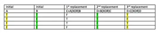

I came across bitwise operations in C programming, and I realized that XOR operator can be used to swap 2 numbers in their binary bases. For example let $$i=(65)_{10}=(1000001)_{2}, \text{ and } j=(120)_{10}=(1111000)_{2}$$.
Let $\oplus$ be the XOR operator, then observe that if I started with any one of them, say $i$ and following the following procedure:
1)replace its value with the $\oplus$ value, yielding $$i=(0111001)_{2},j=(1111000)_{2}$$
2) replace the other variable($j$) with another $\oplus$ value derived from the new $i$ and old $j$, yielding $$i=(0111001)_{2},j=(1000001)_{2}$$
3)replace the original variable $i$ with $\oplus$ value again, yielding $$i=(1111000)_{2},j=(1000001)_{2}$$
which shows that we would somehow have their values swapped. I found this way of programming online and I definitely can’t understand how people think of the logic aspect of this. I would think it’s linked to the truth table as follows, which shows by division of cases that the values can be swapped.
However, I am still uncertain about the full reasoning why this works, like whether there is any mathematical theorems that I should know that can aid me in my understanding.
PS: Sorry if the question is off-topic here, it feels like a programming question, but I feel that I more concerned about the “logic” rather than the programming. I also drew the table myself on MS word since I can't get the latex one to work somehow.

In algebraic terms, the XOR operator (or $\oplus$) is nothing other than addition modulo $2$: use $1$ and $0$ for true and false, along with $1 \oplus 1 = 0$.
Now, since addition modulo $2$ is associative and commutative, and both elements are their own inverses, we have $$\begin{align} d &= b \oplus c\\ &= b \oplus (a \oplus b)\\ &= b \oplus (b \oplus a)\\ &= (b \oplus b) \oplus a\\ &= a.\\ \end{align}$$
We can show $e = b$ using similar reasoning.
